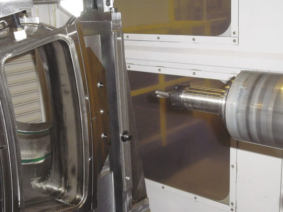

Savannah Machinery Works found that a Walter Titex 3mm (0.12 “) drill provides superior performance and long tool life when cutting Hastelloy X. The point geometry allows drilling on the part radius without using a spot drill.

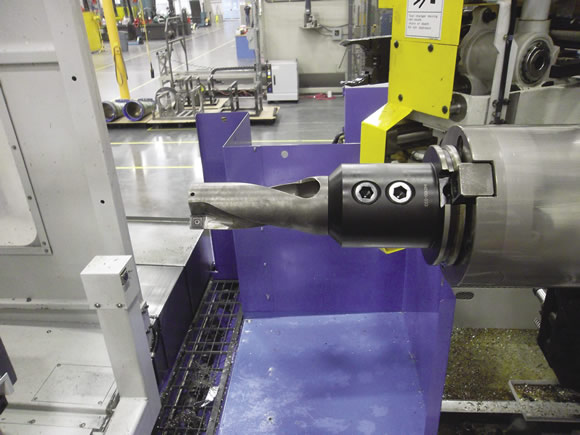

This Sandvik Coromant 17mm (0.67 “) indexable-insert drill is more cost-effective than a solid-carbide drill for producing a low number of holes in a Hastelloy X bracket, according to Savannah Machinery Works. HSS is not capable of drilling the material without risking catastrophic failure.

A Sandvik Coromant 38mm (1.50 “) indexable-insert drill is a good choice for producing holes in Hastelloy X, according to Savannah Machinery Works. The holes could have been drilled with a smaller drill, such as the 17mm one, and enlarged via circular interpolation or boring, but the shorter cycle time for drilling with the larger indexable tool justifies the expense of these drills. Also, the machines that use the larger drills are dedicated to one part family at SMW, so increasing flexibility is not necessary.
