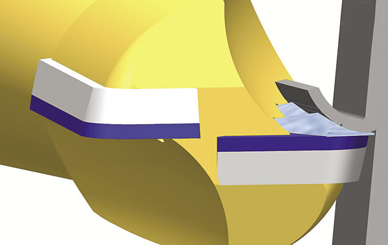

The »Cool Injection« system delivers coolant directly through the PCD cutting face. All images courtesy Lach Diamant.

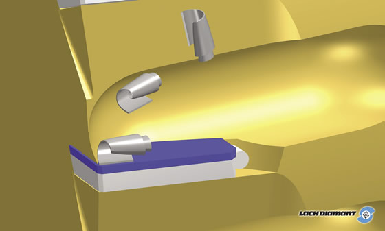

Audi developed the »Plus« chipbreaker.

The through-coolant system delivers coolant directly through the base of the substrate and PCD cutting face, so cooling occurs at the cutting edge, explained Randy Prafke, operations manager for Lach Diamond Inc. “This keeps the heat stable right at the cut.”
In addition to emulsion and oil, the tool is also suitable for cryogenics, such as liquid nitrogen and liquid CO2. However, Prafke noted it has to be a special application, such as machining difficult-to-cut materials like cobalt chrome or hard metal-matrix composites, for that to be necessary.
German automaker Audi AG developed and patented the laser-machined chipbreaker, which Lach Diamant incorporated into the cutter design through a licensing agreement. “The chipbreaker is developing the chip and getting the chip to go in the direction you want it to go so you can deal with it,” Prafke said.
