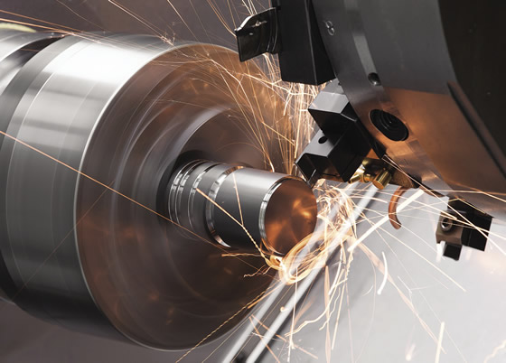

Oil-based lubricants, with or without additives, are utilized to achieve a fine surface quality on the final component. These petroleum or mineral oil products offer excellent lubricity, help prevent rust and are fairly easy to maintain.

Hard turning with PCBN tools is possible under dry conditions.

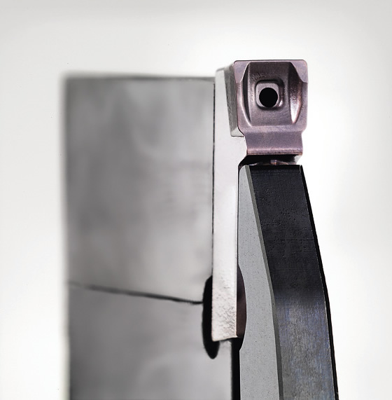

S100.IK_HP65.tif
Horn says its new S100 insert for grooving and parting-off precisely delivers lubricating and cooling fluids. The “.3V” chipbreaker geometry and wear-resistant TiAlN coating for machining stainless steels is an expansion of the existing S100 system. The coolant port works directly at the cutting zone and creates a focused coolant jet, reducing the chance of built-up edge and assisting in chip formation.
However, using high-pressure coolant provides significant advantages over flooding the workpiece with large volumes of coolant. With as little as 73 psi (5 bar) of pressure, tool wear begins to decrease compared to using flood cooling alone, which increases productive machining time. Built-up edge begins to decrease when the pressure exceeds 290 psi (20 bar), decreasing machine downtime. In addition, breaking chips in long-chipping materials, such as high-strength nickel-base alloys, is possible above 2,175 psi (150 bar).

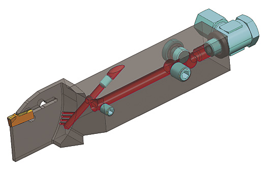

001.0040.2089.00.ASM.1.tif
A VDI holder with coolant channel (shown in red) supplies coolant directly through an indexable insert.

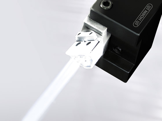

LH100.2020.33.IK.00.AS.1.tif
A square shank part-off holder with coolant jets provides pressurized fluid below the cutting zone.
The growing demand for efficiency when grooving modern steels with their increased levels of strength and toughness have led to improvements in cutting tools. Innovative tool manufacturers are addressing these trends and have developed new cooling processes involving high-pressure streams of coolants and lubricants. These developments include a variety of methods to transport fluids through a toolholder and aim a focused coolant jet directly toward the workpiece via coolant nozzles, clamping mechanisms or other suitable surface. Grooving tools that feature internal plumbing enable fluids to reach their intended destination and reliably evacuate chips. As a result, coolant delivered through tooling has considerably increased tool life and increased productivity by improving process reliability.

Advancements in carbide substrates have made it possible to place a coolant port just behind the cutting edge of an insert. While solid tools with through-coolant capability have been on the market for many years, high-pressure coolant streams and cryogenic liquids are now forced through toolholders and the indexable cutting inserts they support.
Cutting fluids delivered through an insert that are accurately directed into the cutting zone aid in chip formation, chip removal and effective cooling of the cutting zone. Pinpoint coolant placement further reduces tool wear, increases process reliability and allows higher cutting parameters.
