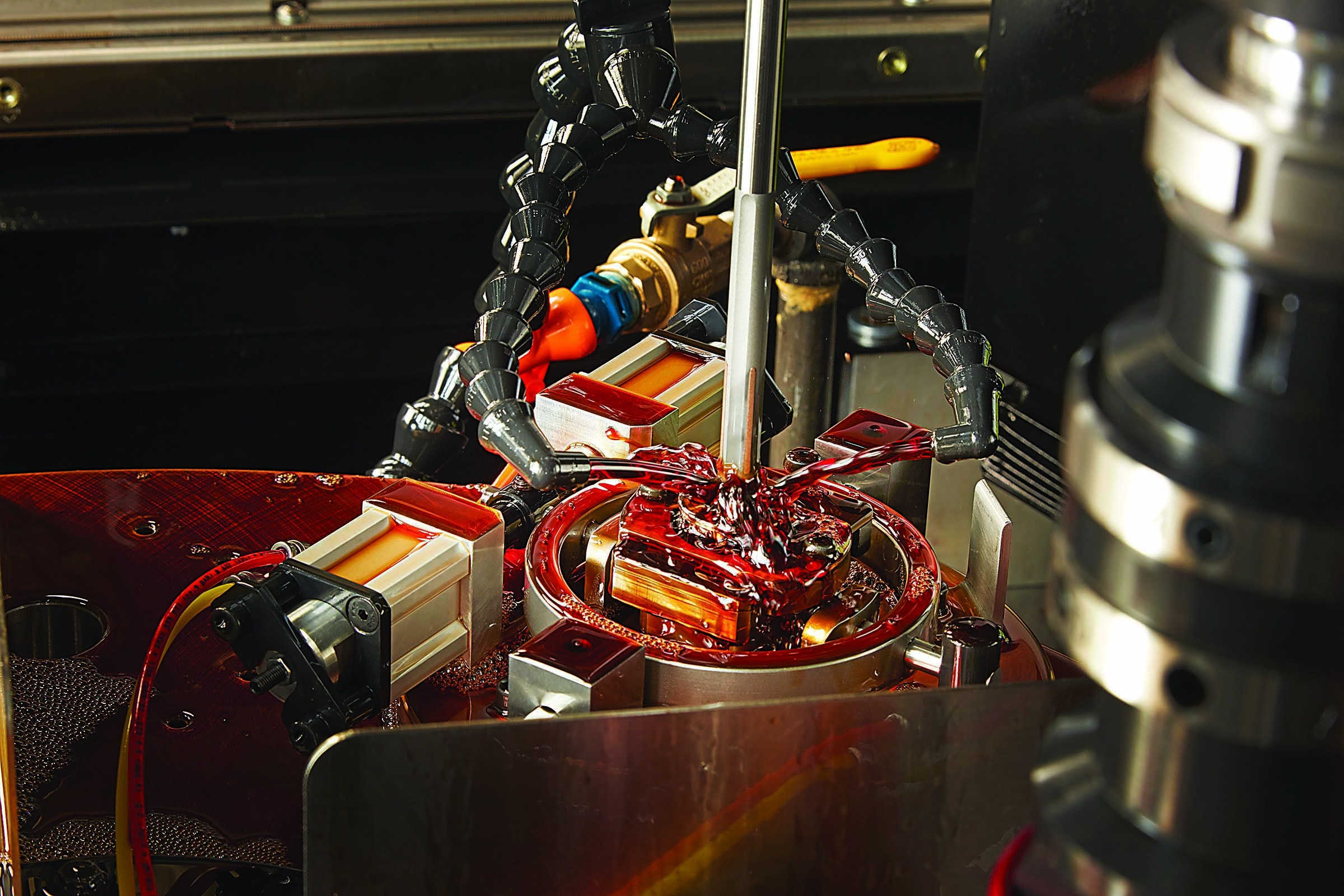

All of Sunnen’s honing machines are designed for wet honing, mostly with oil (pictured) but also using water-miscible fluids. Image courtesy of Sunnen Products
If the parts are appropriate, a vertical machine provides a solution to avoid a centerline shift, Westhoff added. Compared to a horizontal platform, a vertical arrangement is “more production worthy” because multiple vertical spindles can be arranged side by side to perform roughing, semi-finishing and finishing, for example. “You basically can stack three machines, in essence three vertical spindles next to each other, to perform those three operations.”
Regardless of the orientation or application, he noted that all the company’s honing machines are designed for wet honing, mostly with oil but also using water-miscible fluids. “I’ve been doing this for over 27 years and maybe have honed a few pieces by hand — dry — over the years.”
