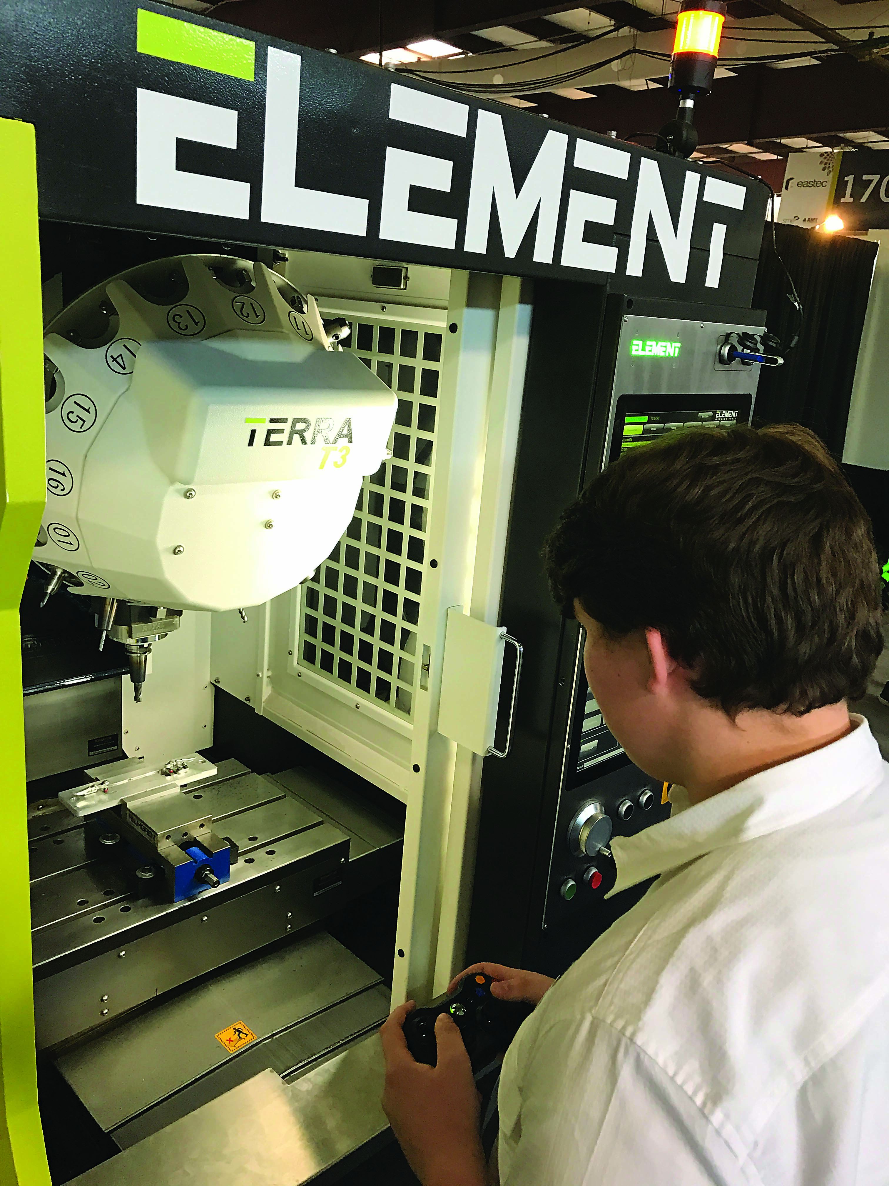

Ben Brown, vice president of sales and marketing at Element Machine Tools Inc., offers several reasons why a custom CNC machine is often a better solution than a stock machine. “Our customers can take an à la carte approach to machine selection. They can pick whatever technology is most important to them, and we’ll design the machine accordingly,” he said. Customers can avoid having to buy a machine that costs considerably more money with options they don’t particularly need or care about, Brown added.
Custom machines offer solutions standard ones sometimes can't
Equipping machines with Xbox-style controllers might be a great way to get young people interested in machining. Image courtey of Element Machine Tools.

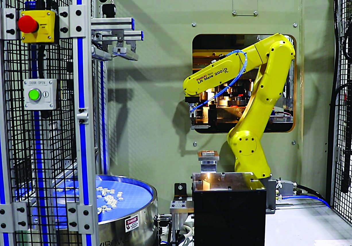

Autoloaders and other types of automated material-handling systems are a common addition to many machine tools.

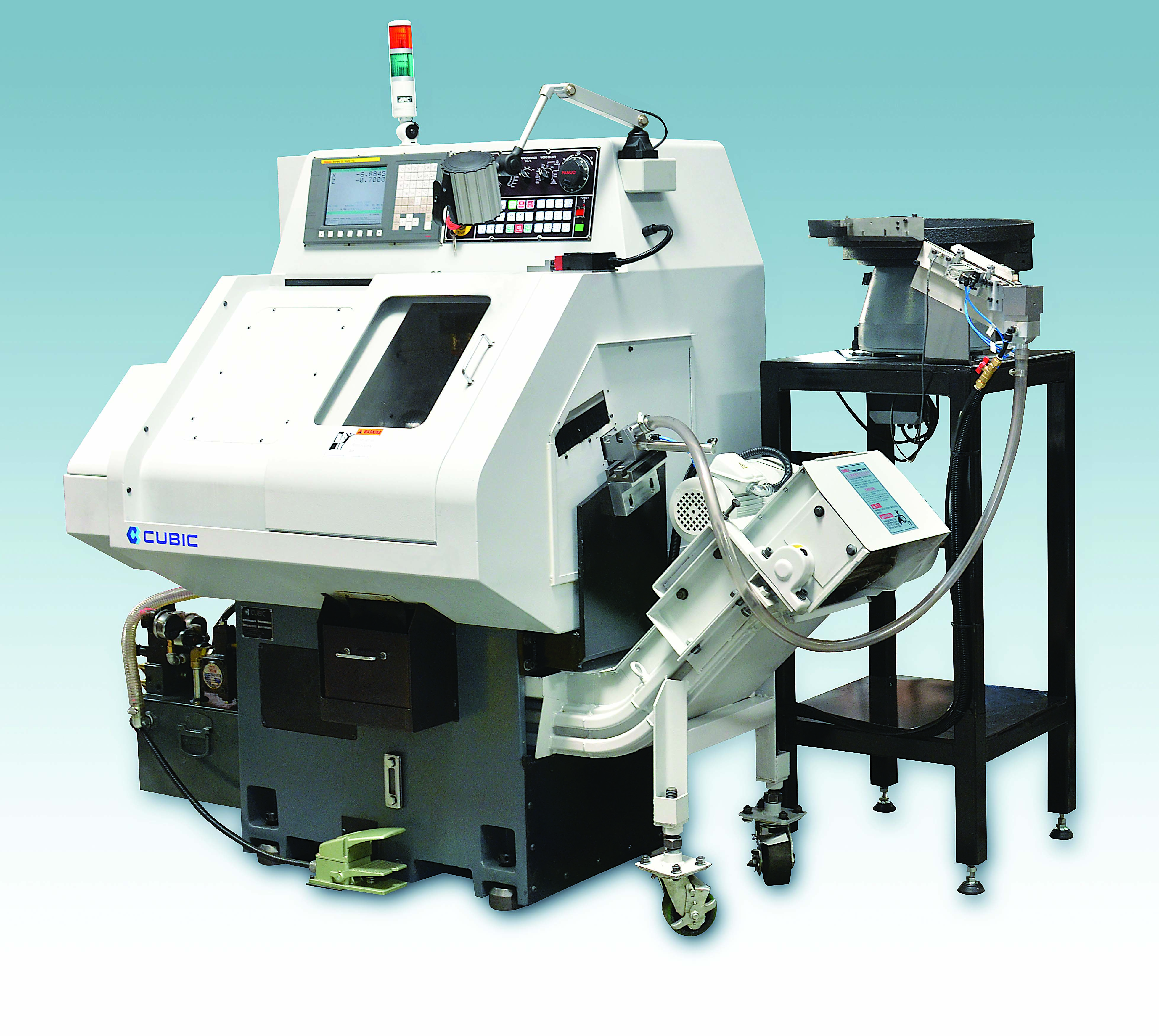

Joe Lin, president of Chino, Calif.-based Cubic Machinery Inc., said adding automation accounts for roughly 70 percent of the company’s custom work. Many of his customers are seeing work come back from China, but the market remains very competitive, especially in California, where wages are high, he added.
“That’s why a lot of people want to automate their machine tools,” Lin said. “For example, we might mount a PLC on one of our gang-style machines and equip it with a parts loader and a mechanism for flipping the part. Sometimes we’ll equip a machine with a vision system for in-process measurement or integrate a 6-axis robot into an unattended machining cell.”
Lin added that customization—whatever form it takes—adds value to the machine tool while reducing operational costs.
One example is Cubic Machinery’s TS-1000, a machine for producing high volumes of aerospace fasteners. Lin said most of the screws, bolts and pins used in the aerospace industry are produced on cold-heading machines, which often produce part features insufficiently accurate for aerospace work or require modification. Typical operations include grooving, burnishing, cross-hole drilling, pointing and slotting. By equipping one of Cubic’s standard machines with a load/unload mechanism, together with whatever auxiliary machining head is needed to modify the part, manufacturers can produce thousands of accurate custom fasteners daily in untended operations.

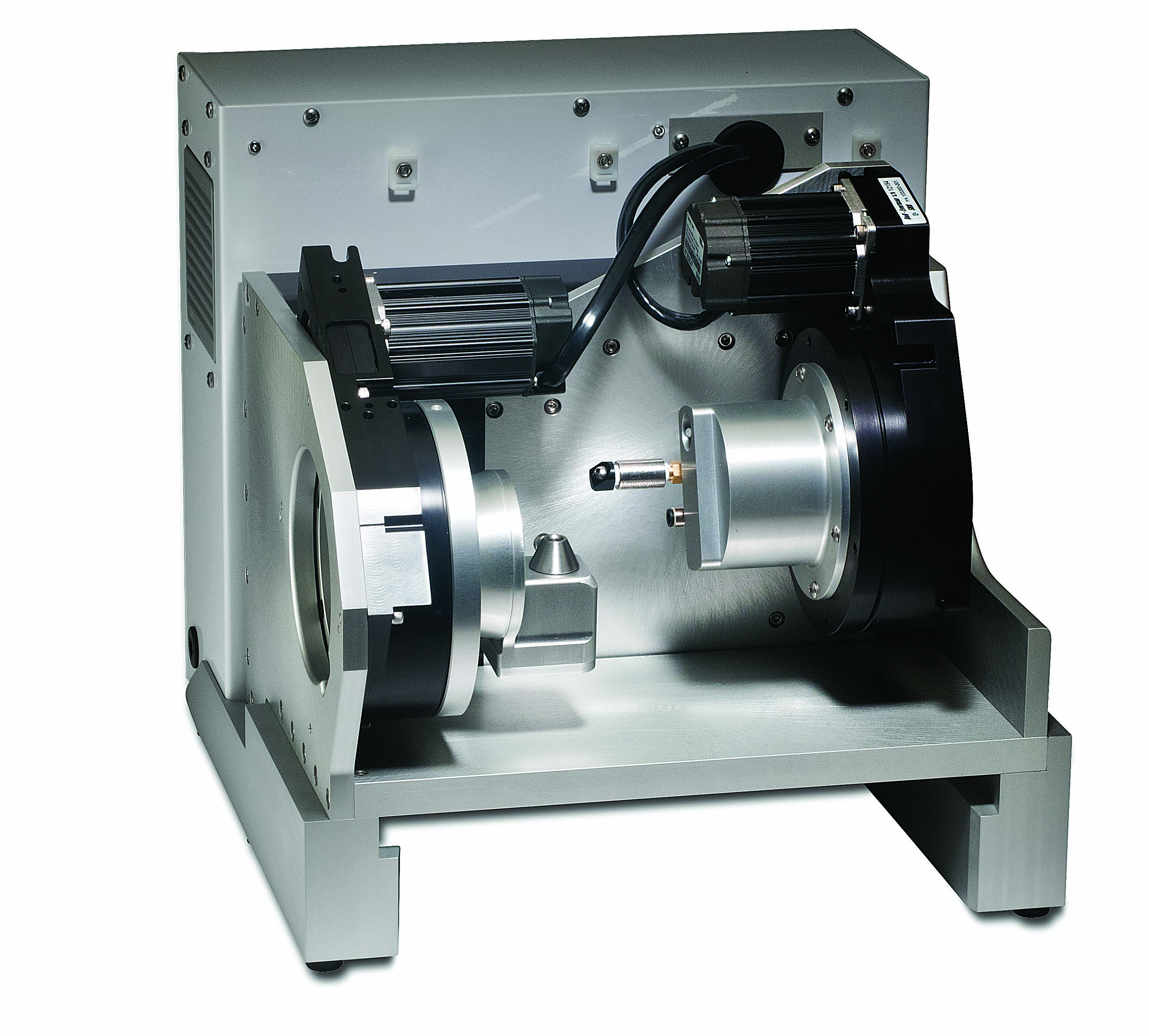

Just up the coast from Cubic Machinery sits another custom machine tool provider and automation integrator, Bell-Everman Inc., Goleta, Calif. President Tom Maccianti said the company started as a provider of linear and rotary stages for the semiconductor industry, but increasingly found itself designing and building custom automation systems and subsystems. One of these systems was for a tabletop milling machine for a dental-products provider.
Maccianti explained that the customer had recently acquired an intraoral scanning company and wanted to complement its product line with a dental-implant machining solution.
He said: “Rather than design and build a traditional 3-axis, XYZ mill, we used two rotary tables and polar-coordinate positioning, as well as Delta Tau controls, to convert the G code into the right coordinates. One table held the workpiece and the other the spindle, which was mounted on a linear stage. It took just 18 minutes after pushing the green button to have a finished tooth, ready for implantation.”
