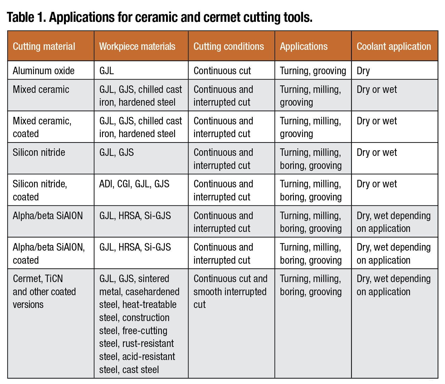

Because SiN and SiAlON are relatively tough ceramics, especially at elevated temperatures, tools made of these materials are best-suited for roughing cast iron and heat-resistant superalloys (HRSAs), Wilshire said. “The Al2O3-based ceramics are still pretty brittle, so those are mainly for hard turning with no interruptions or for finishing cast iron.”
According to Steve Howard, marketing and engineering manager for NTK Cutting Tools USA, Wixom, Mich., SiN-based ceramic grades, such as NTK SX6 and SP9, have twice the fracture toughness of alumina-based ceramics. This level of toughness enables turning and milling cast iron at speeds up to 3,000 sfm.
In addition, NTK’s SiAlON grades blend the strength of silicon-nitride ceramic with the heat and wear resistance of alumina oxide, Howard said. “NTK’s five grades, with SX3 being the newest, feature excellent strength and thermal shock resistance under high temperatures, as well as notching resistance, which are ideal characteristics for high-speed machining of heat-resistant alloys common in aerospace, power generation and oil and gas industries.”
NTK’s five grades of black ceramics—alumina with hard carbide added to improve toughness and hardness—have a high-hot hardness and low plasticity to turn steel, chilled or ductile iron rolls and some powdered metals as hard as 62 HRC, Howard said. “Our finest grain structure—ZC4 grade—can perform finishing cuts on steels up to 70 HRC. These ceramics are cost-effective alternatives for applications previously limited to CBNs.”
Like the name implies, cermet combines ceramic elements (such as TiC, TiCN and molybdenum carbide) with metallic binders (such as nickel, as well as molybdenum and cobalt to a lesser degree), Wilshire noted.
Cermet is more brittle than tungsten carbide, so cermet cutting tools are susceptible to chipping and breaking when stressed while taking heavy cuts, he said. As a result, more users consider cermet tools suitable for finishing only at a 0.010" to 0.020" DOC. However, Kyocera has developed cermet tools that can take a 0.060" to 0.080" DOC in “clean” material.
“If you have interruptions or scale, carbide is still going to be the way to go there,” he said.

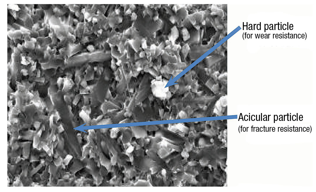

Greenleaf Corp., on the other hand, is well-known for its whisker-reinforced ceramics, having introduced the uncoated WG-300 grade in 1985, said Jan Andersson, global director of the TechTeam and marketing for the Saegertown, Pa., toolmaker. Greenleaf later introduced the WG-600 coated whisker-reinforced ceramic followed by the WG-700, which has a different substrate and a nanostructured coating.
“There are a lot of applications where whisker-reinforced ceramics are still—by far—the best solution,” Andersson said.
A more recent development from Greenleaf is its XYSTIN-1 phase-toughened ceramic. It is a thermally stable, whisker- and particulate-toughened SiN with almost twice the strength of any other commercially available ceramic tool from Greenleaf, the company reports.
In theory, all ceramic tools remove metal by raising the temperature in the cutting zone to a level that causes the material to plasticize, which makes it easier to machine, Andersson said. Without plasticization, tool edge chipping and top and flank slicing can occur.
“That’s when you see catastrophic failures,” he added. “But once we get to XYSTIN-1, the theory goes out the door.”
According to Andersson, the phase-toughened ceramic’s high strength enables an XYSTIN-1 tool to efficiently cut without the need for full plasticization to occur. This ability is beneficial when turning a large and heavy or imbalanced part that’s not practical to spin at high speed. For instance, when machining an imbalanced part made of Inconel 718 with a hardness of 46 to 48 HRC, the low-end cutting speed needed for ceramics to plasticize the material is about 550 to 600 sfm. In contrast, an XYSTIN-1 insert can run at 350 to 400 sfm whereas a carbide tool would reach only 150 to 180 sfm.

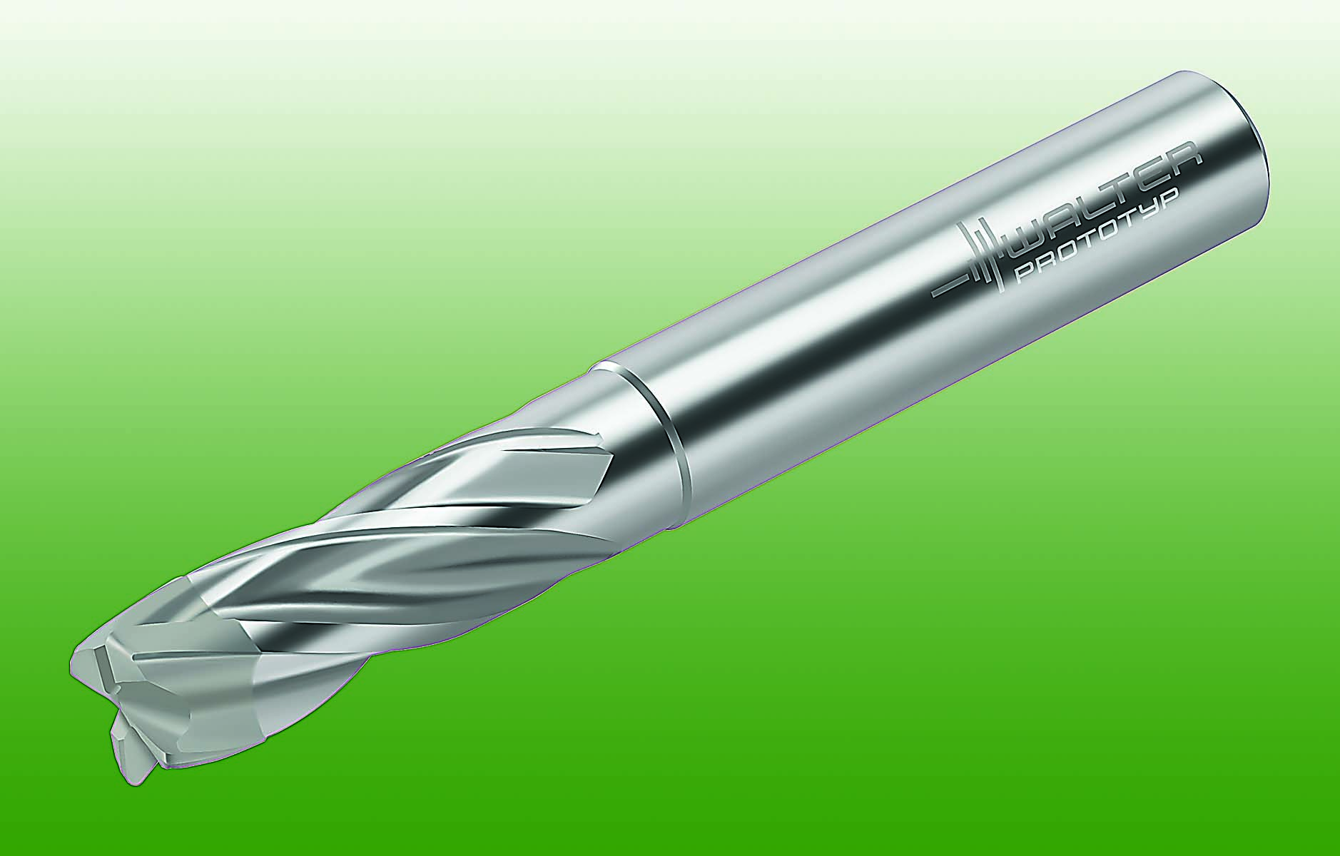

Another type of “hybrid” tool is available from Walter USA LLC, Waukesha, Wis. The MC275/MC075 Walter Prototyp ceramic milling cutters have a ceramic head brazed onto a solid-carbide shank. The toolmaker also offers a design with interchangeable ceramic heads that can be screwed onto a shank. The target application is milling HRSAs.
The MC275 features a universal geometry for multiple purposes while the MC075 has a geometry for achieving high feeds in challenging materials. Both designs can achieve cutting speeds up to 3,300 sfm. “We are almost reaching values that are usually seen in aluminum machining, with a feed of up to 380 ipm,” said Stefan Benkóczy, component manager of aerospace and business application development for Tübingen, Germany-headquartered Walter AG.

When the application is appropriate, cermet cutting tools exhibit significantly high cutting-edge stability and moderate toughness, stated Joachim Beck, marketing manager for CeramTec GmbH, Plochingen, Germany. (CeramTec North America Corp. is based in Laurens, S.C.) These properties make cermets well-suited for finishing and fine finishing a variety of workpiece materials, including ductile cast iron, free-machining steel and casehardening steels. Suitable applications include turning, milling, continuous-cut boring and smooth interrupted cuts. (See Table 1.)

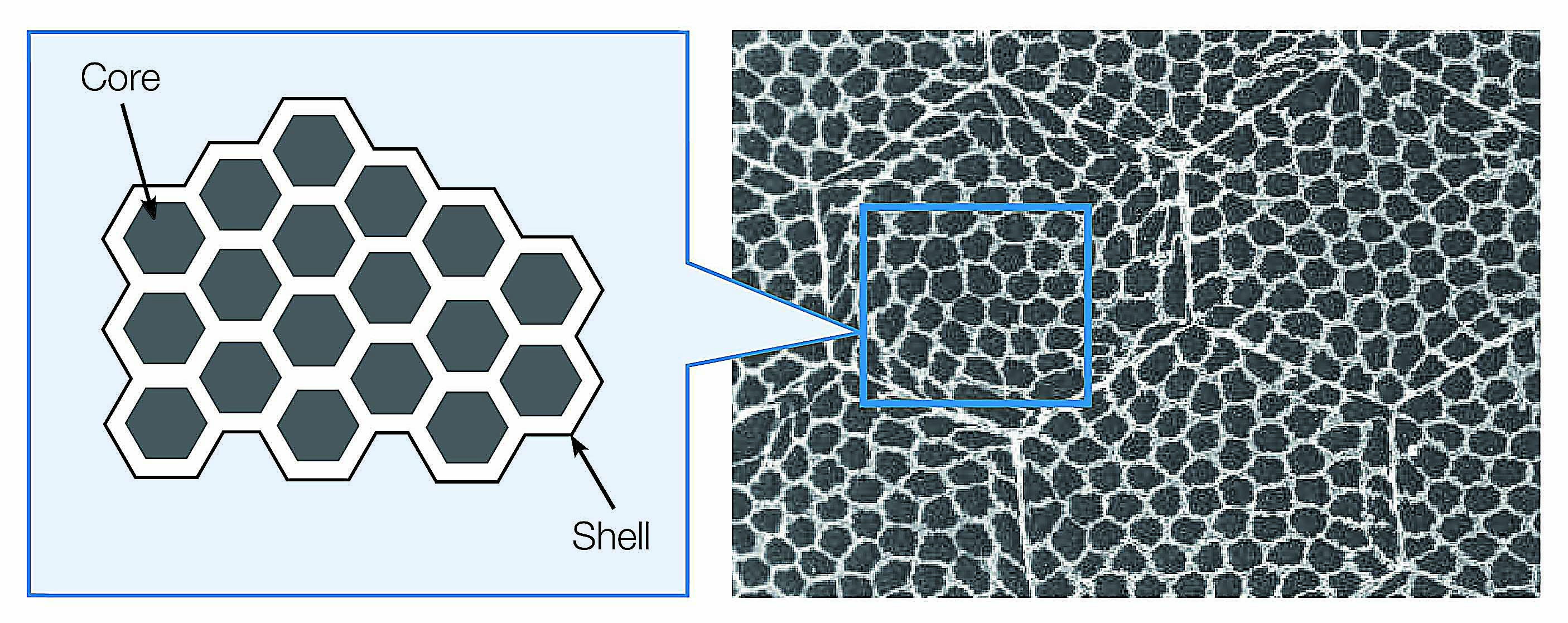

Kyocera’s cell fiber ceramic grade CF1 has a honeycomb-shaped grain structure in which the hexagon shape that forms the honeycomb is made of tougher ceramic than the harder central core that it surrounds. Image courtesy of Kyocera Precision Tools
