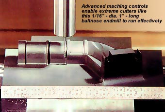

Advanced machine controls enable extreme cutters like this 1¼16″-dia., 1″-long ballnose endmill to run effectively.
Improved milling-cutter performance can help shops run their CNC machines at higher speeds and feeds without sacrificing part accuracy. More, lighter passes can be taken to keep the heat out of the part and the cutter to improve surface finish while decreasing cycle time. Shops can achieve faster delivery, higher productivity, and greater accuracy—provided that their machine controls give them adequate control over the cutting edge to handle light passes at high speeds and feeds.
