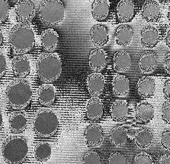

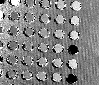

A comparison of 0.2 “-dia. holes in a ceramic matrix composite produced with IKONICS’ particle beam technology (top), showing no burrs, delamination or fiber splintering, and via drilling (two left rows in bottom photo) and waterjet cutting (three right rows in bottom photo).
