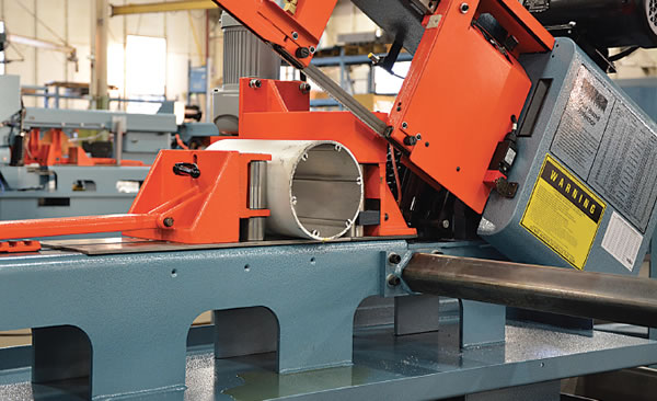

A DoALL saw cuts round pipe. Image courtesy DoAll Sawing Products.

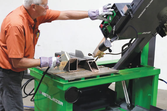

Dave Gillaspy, MetalMizer Product Manager, Wood-Mizer LLC, Indianapolis, explained how relatively small advancements in saw design helped. “MetalMizer got its start because hands-on fabricators wished their cutoff saw would just tilt a little bit forward, cut at a 45° angle in either direction, have finite adjustments on the feed force, and could offer all this without a bunch of bells and whistles,” he said.

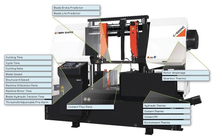

“We have a recent product called ‘MechaLogix,’ a full Industry 4.0 monitoring/communication device that we can put on our bandsaws,” Finklea said. “It predicts blade life and breakage and can send it to the cloud, so it can be accessed by phone from anywhere.”
