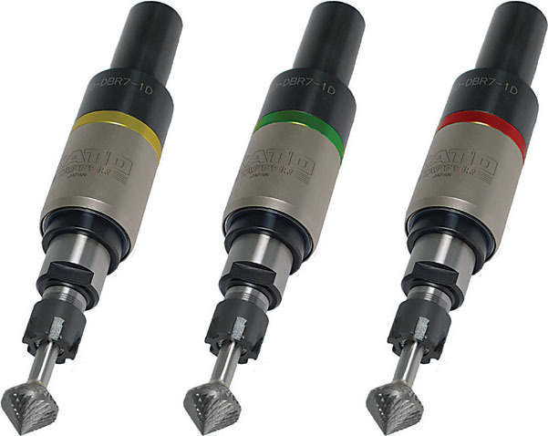

The FM-DBR7-1D series includes three holder options that each provide a specific spring load for different cutting-pressure requirements. Bel Air Finishing

New to the North American market, Kato’s FM-DBR7-1D series deburring toolholder is designed for automated top and bottom (tension and compression) deburring of machined holes in one pass, eliminating tool changes. By compensating for workpiece dimensional changes during production runs, its telescopic compression/tension mechanism is meant to ensure consistent deburring volume and stable cutting performance even in high-mix, variable-batch operations. Originally developed for cast iron, the 1D series now includes three holder options that each provide a specific spring load — light, medium or aggressive — for the different cutting- pressure requirements of a variety of materials, including aluminum and stainless steel.
