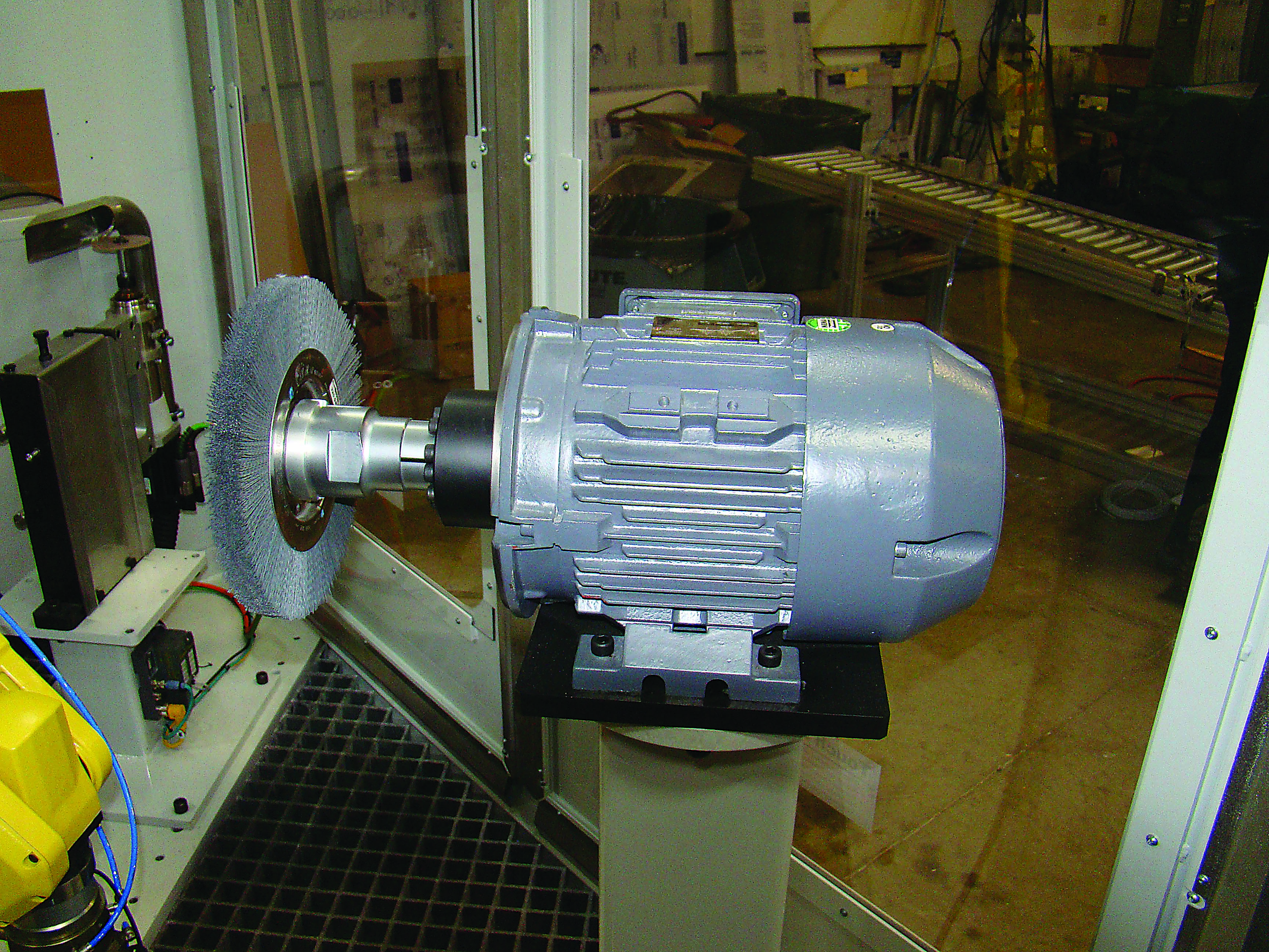

A host of methods exist for deburring parts, such as this motorized brush from the Deburring Applications Laboratory at Matrix Design LLC. Image courtesy of Alan Richter.

Deburring is almost always considered a secondary operation performed after machining, by hand and off the machine. A better option is to develop machining processes that eliminate the need to deburr off the machine.
Sometimes, burrs can be eliminated by programming a machine’s CNC to add a deburring operation while the part is on the machine. Examples include programming a chamfering tool to take a pass along the edge of a hole, milling a chamfer on a sharp edge and programming a radius on the edge of a part.
In other situations, special-purpose deburring tools can be purchased. These tools are made with retractable blades that deburr both sides of a through-hole. Many machine solutions exist to support deburring in the machine tool.
