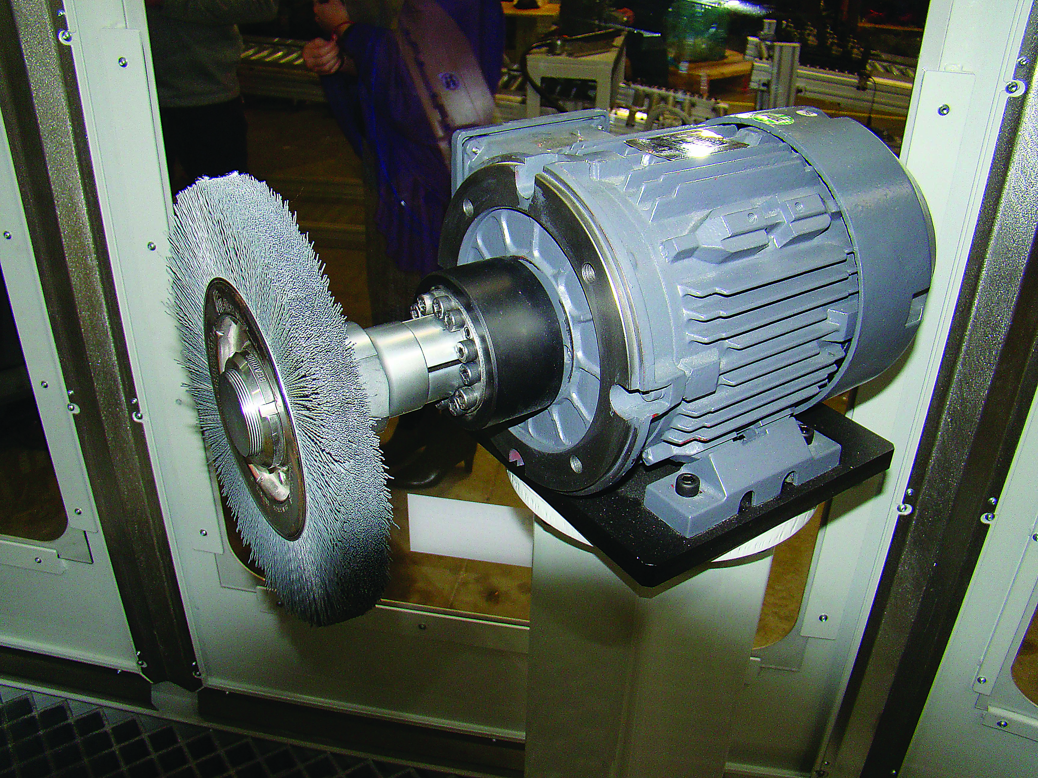

Developing the deburring process involves selecting from a host of deburring tools and determining the proper parameters to run those tools. The tools include various brushes and abrasive wheels that generate different results. “Deburring is very delicate,” Bennett said. “If you push too hard and give too much force, you start removing material that you didn’t want to remove in the first place. If you go too lightly, you might never remove the burr.”
Jeff Bennett (left), vice president of sales and marketing, and Michael J. O’Reilly, vice president of operations, in front of the Matrix Deburring Applications Laboratory at its previous location in South Elgin, Ill. Image courtesy of A. Richter.
The software-based method that Matrix employs to accurately adjust how much pressure a robot exerts on the workpiece being deburred is called “touch detection,” Bennett said. “As soon as contact is made, the system knows that contact has been made and the robot can adjust its pressure.”
Touch detection also provides automatic tool-wear compensation and adjusts the speeds and feeds as needed.
