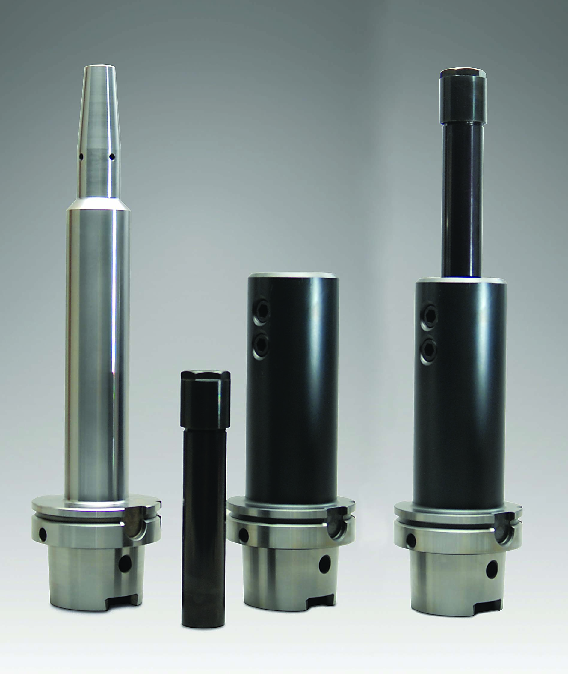

It has become commonplace to “stack up,” or combine, standard holders in an assembly that enables a cutting tool to get where it needs to be. Figure 1 shows a single-piece toolholder next to an unassembled and assembled two-piece toolholder.
Stacking makes sense, particularly because a range of suitable standards are often on hand. The practice involves combining different types of holders, and possibly extensions, to replicate what would otherwise be accomplished with a dedicated, or special, toolholder.
Figure 1. A single-piece toolholder (left) next to an unassembled (center) and an assembled two-piece toolholder that performs similarly.

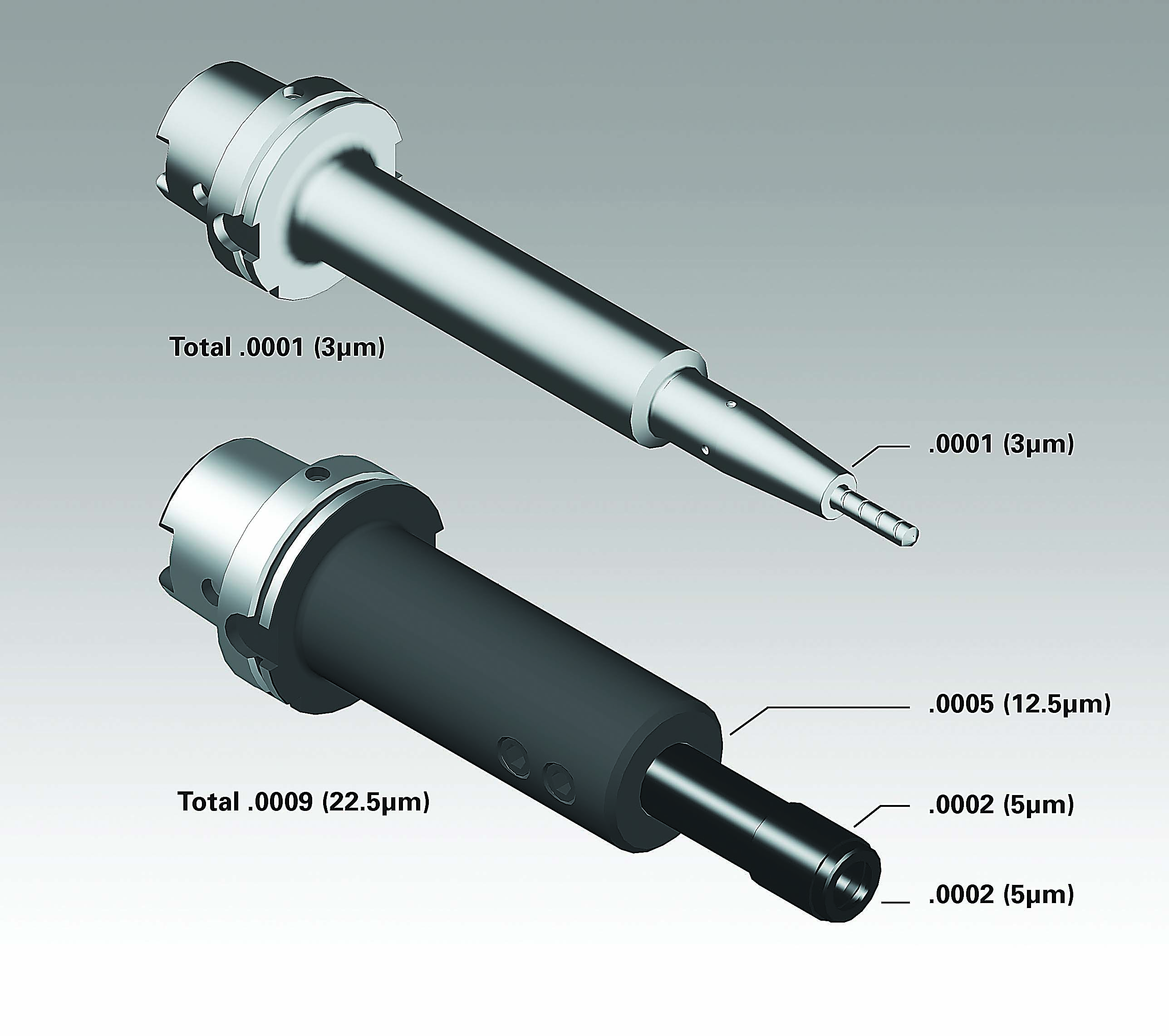

Consider a long-reach drilling application. Figure 2 shows the choice between a single-piece holder and a typical stack-up holder. The single-piece holder is an HSK 100A, 12mm (0.472") shrink-fit holder with a 360mm (14.173") projection. A holder like this features a custom, extended length with a slim-nose design to maximize rigidity. It is dual-plane-balanced to a G2.5 tolerance at the customer-specified rpm to reduce vibration and chatter. The holder has balance screws in the nose that allow the user to finely balance the holder after installing the cutting tool. Users can expect a tight tolerance of 0.0001" (3µm) TIR from a custom holder like this.
The assembly on the bottom of Figure 2 is comprised of two holders: a standard HSK 100A 1.25" (31.75mm) endmill holder and a 1.25" straight-shank collet extension. Both the holder and extension in this assembly meet industry-standard tolerances. The holder has a tolerance of 0.0005" (12.5µm) TIR, and the collet extension has a tolerance of 0.0002" (5µm) TIR. The connections are reliable and meet the required projection and nose configuration.

Despite saving time and money, there are some downsides to stack-ups that are worth mentioning. As previously noted, the custom holder has a single tolerance of only 0.0001" TIR. Keep in mind that any time two or more holders are combined, tolerance stack-up occurs. In the example with the TIR of 0.0002" and 0.0005" for the holder and collet extension, respectively, the tolerance stack-up causes more total runout, possibly beyond an acceptable amount.

Figure 2. The single-piece toolholder (top) is an HSK 100A, 12mm shrink-fit holder with a 360mm projection. The assembly (bottom) is comprised of two holders: a standard HSK 100A, 1.25" endmill holder and a 1.25" straight-shank collet extension.
