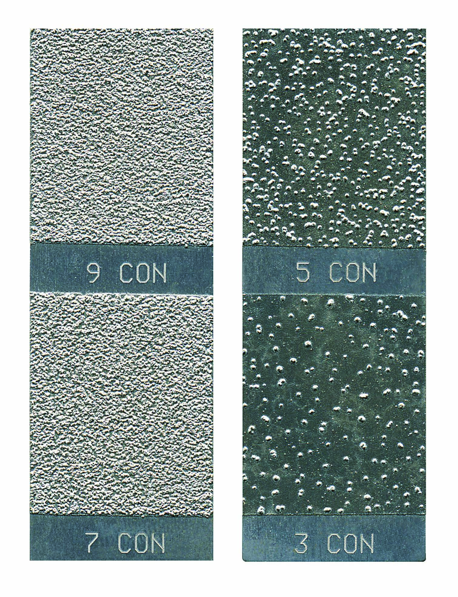

Examples of braze bond concentrations are displayed. Image courtesy of Abrasive Technology

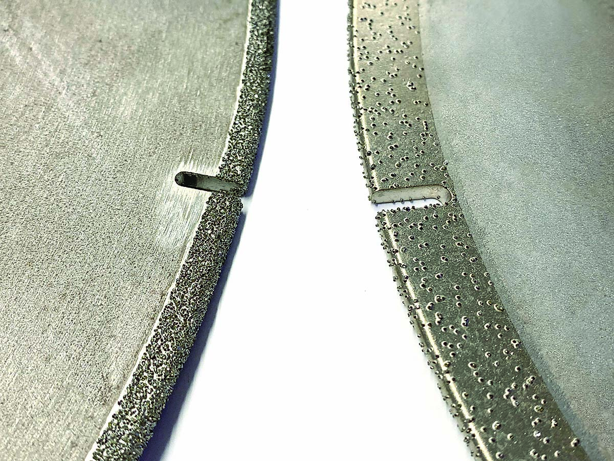

A standard braze bond saw (left) and a low-concentration braze bond saw are shown. Image courtesy of Abrasive Technology

Reducing the diamond concentration on the tool is a way to mitigate these competing forces. The sweet spot for diamond concentration on the tool will depend on the properties of the material being cut and the processing speeds available. We have found the ideal concentration to be between 30% and 70% of the standard full diamond coverage.
Two versions of a single-layer brazed diamond saw were tested against a PCD-tipped saw in a cutoff application. The material was a wood-fiber-filled thermoplastic. The blades were all 18″ dia., the saw ran at a fixed 1,750 rpm (8,247 sfm), and the feed rate was approximately 200 ipm. The diamond saws were brazed bonded 20/25 mesh abrasive, and the PCD saw baseline was 40,000 cuts. The standard-concentration diamond completed about 20,000 cuts, so it was not economically feasible. A second saw blade with the diamond coverage adjusted to 40% concentration made 220,000 cuts. (See the second photo.) This reduced the tooling cost per cut. The reduced-concentration diamond saw also cut more accurately and left a better edge. This generated additional savings as the cut length was reduced closer to the final specification, generating less waste material.
