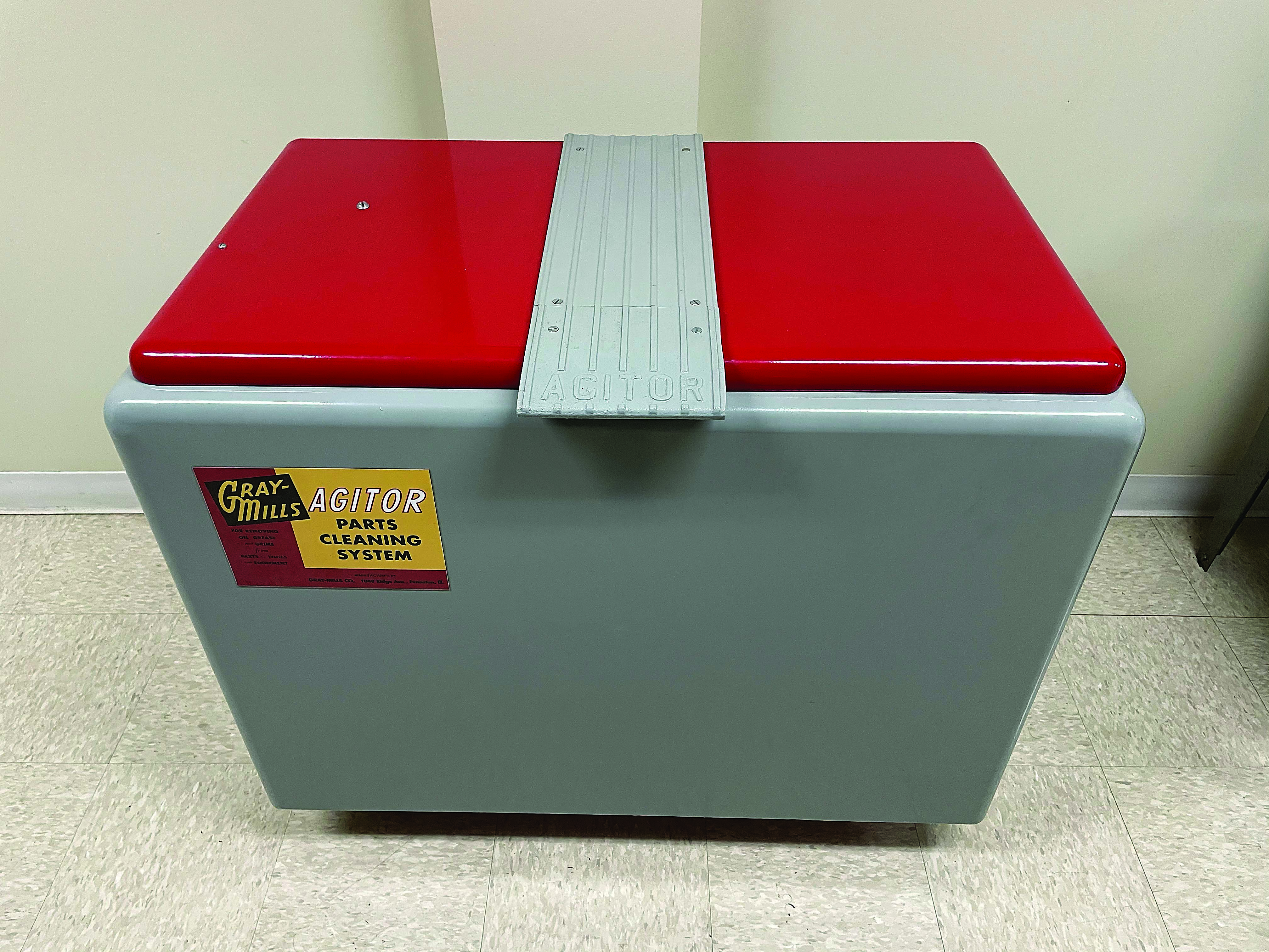

An automatic, agitating immersion cleaning machine is shown. Image courtesy of Graymills
