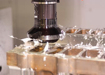

Bill Miller Engineering uses a variety of Sandvik Coromant milling tools when producing high-performance engine parts.
“The inside of the blower casing for our superchargers is an extreme manufacturing challenge,” Whitener said. “Because of the intricate work needed inside the case, we originally had to machine an insert, cut a hole in the case and then bolt the insert in.”
After reviewing the job, Sandvik Coromant representatives recommended using a Coromant Capto toolholder in combination with several of the company’s CoroMill ballnose endmills. The holder provided both the reach and stability needed to machine the complex geometries inside of the blower case.
“We saved quite a bit of time with the new process, but that wasn’t even the important part,” Whitener said. “The stability of the Coromant Capto system let us machine the entire component from a solid block, which simply wasn’t possible before. The resulting increase in quality was huge. In the past, over-revving the engine could result in ruining a blower casing. Now the product has much more strength and integrity. The revamped design also increased airflow through the supercharger, allowing for higher levels of performance.”
