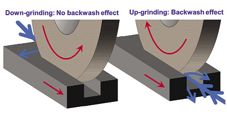

Figure 1. Down-grinding vs. up-grinding when creep-feed grinding deep grooves. Illustration courtesy J. Badger.

Dear Doc: You always say there is almost no difference between up-grinding and down-grinding in terms of temperatures, surface finish and wheel wear. But I down-grind when creep-feed grinding deep slots and it seems to help avoid burn. Why?
The Doc Replies: The one exception to my “up or down, it doesn’t matter” advice is when creep-feed grinding features such as flutes, fir-tree roots and deep grooves (Figure 1). It has to do with cooling.
When up-grinding a deep groove, for example, the process creates a sort of cave, which causes the “backwash effect.” Any coolant that doesn’t penetrate the grinding zone—and 99 percent of coolant doesn’t—can’t just spill over the sides as when down-grinding. It gets stuck in the cave, creating the backwash effect. This seriously hinders the amount of coolant that can get in the grinding zone. Therefore, I recommend down-grinding.
