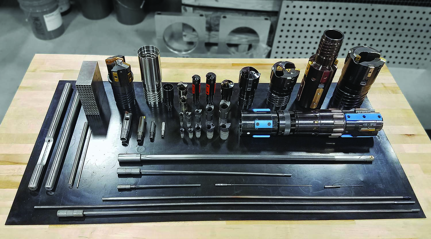

While drilling is one of the most common machining processes, deep-hole drilling is a specialized segment in and of itself.
While drilling is one of the most common machining processes, deep-hole drilling is a specialized segment in and of itself. Image courtesy of Unisig

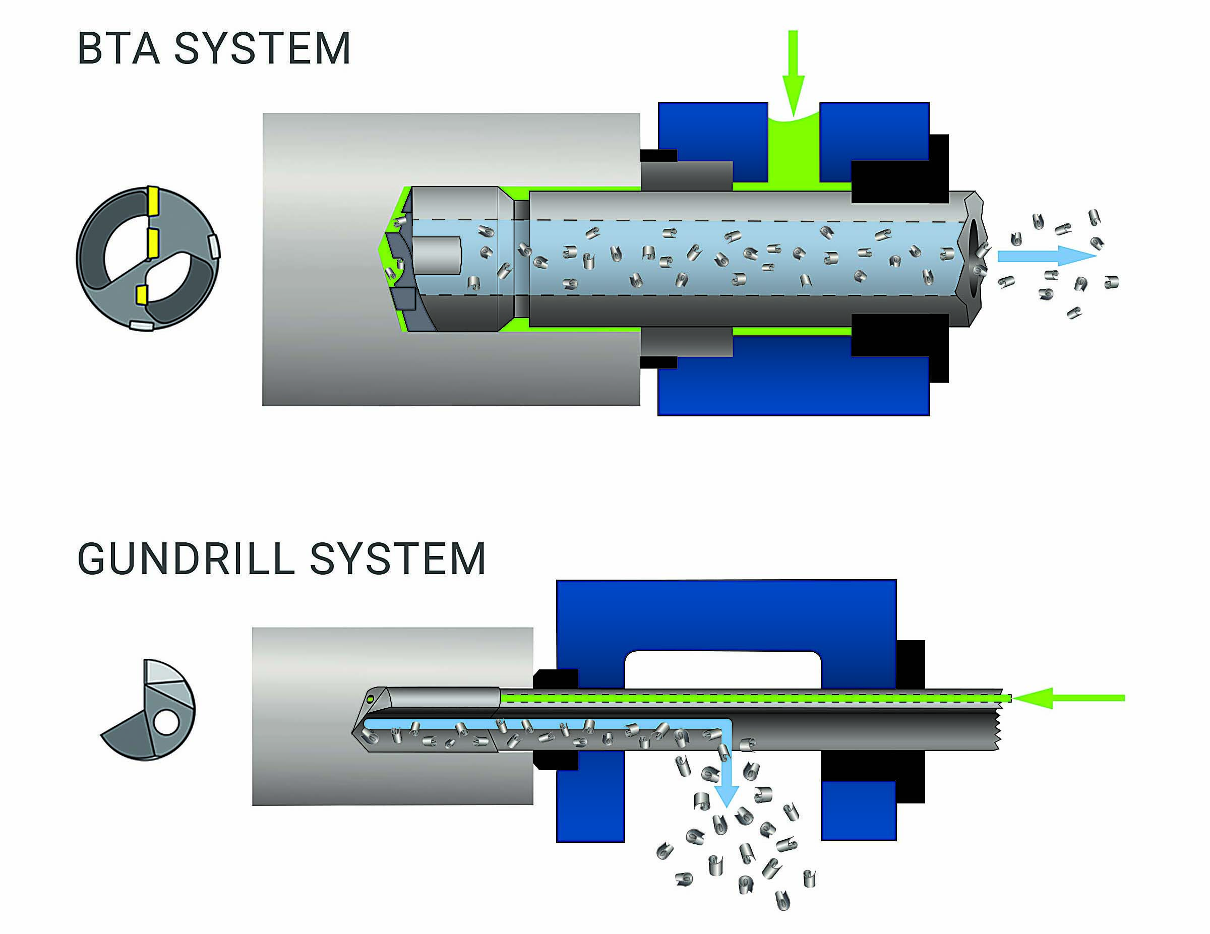

Compared with gundrilling, in which through-tool coolant is introduced at the cutting zone and forces chips out through the drilled bore, the BTA system essentially operates in reverse. In BTA drilling, coolant is fed outside the drill tube through the drilled bore to the cutting zone. Chips then are evacuated through the center of the drill, eliminating the chance that they will scar the drilled bore surface. BTA application diameters generally start at 1", but use is more common at diameters greater than that, and the process shows benefits in 20" and larger bores.
Compared with gundrilling, in which through-tool coolant is introduced at the cutting zone and forces chips out through the drilled bore, the BTA system essentially operates in reverse. Image courtesy of Unisig
