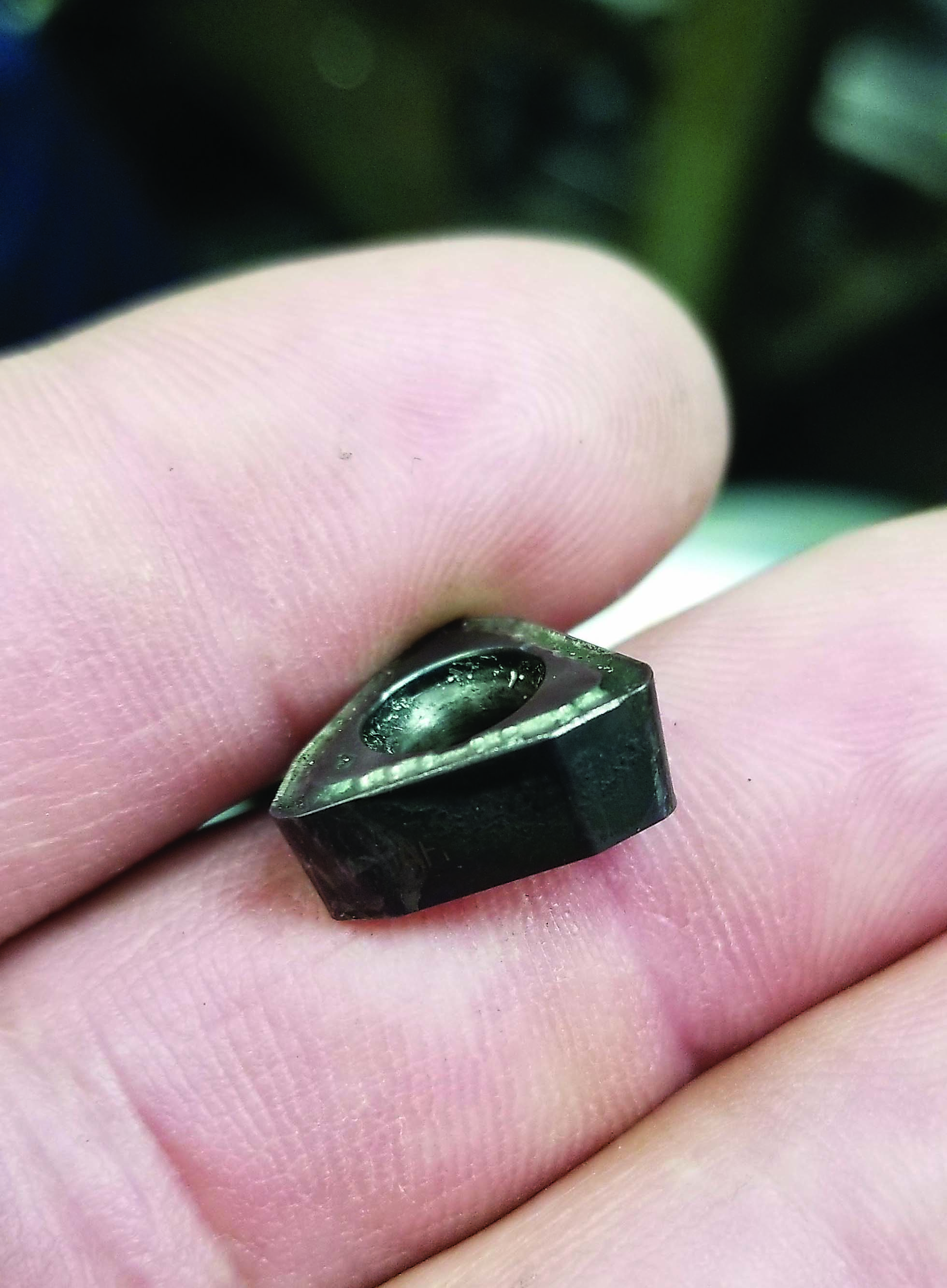

An insert from a TungSix-Drill shows wear after machining a reducer part. Image courtesy of MetalTek International

Geyer conducted a test to determine how the TungSix-Drill compared with the drill that MetalTek International used, as well as a drill from another cutting tool manufacturer. That third tool from a different toolmaker performed better than the original drill but had to run at about 27 m/min. (90 sfm). In comparison, the TungSix-Drill ran at a cutting speed of 52 m/min. (170 sfm) during the test. Results showed that the original drill was able to run at a cutting speed of 30 m/min. (100 sfm), a feed rate of 25 mm/min. (1 ipm), a spindle speed of 129 rpm and an operation time of 463 seconds per hole. In contrast, the TungSix-Drill ran at a feed rate of 51 mm/min. (2 ipm), a spindle speed of 220 rpm and an operation time of 273 seconds per hole while producing 24 holes.
The drill cost analysis indicated that the original drill had a $14.28 cost per drilled hole and a $13.26 machine cost per hole for a $27.54 total cost per hole. The TungSix-Drill, on the other hand, had a 45-cent drill cost per hole and a $7.80 machine cost per hole for an $8.25 total cost per hole. For the 1,000-part job, MetalTek International reduced costs by about 70% through switching to Tungaloy America’s drill.
