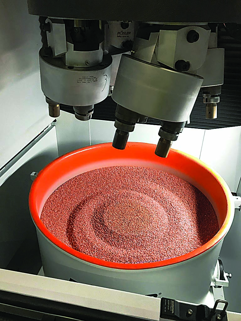

The processing bowl of the R 4/700 SF drag finisher can be exchanged by a forklift to switch from one application to another without having to replace the processing media. Image courtesy of Rösler Oberflächentechnik
The drag finisher is carousel-equipped with four rotary spindles, and three workpieces can be mounted on each spindle, according to Rösler Oberflächentechnik. The carousel and spindles have separate drive motors, allowing the setting of different rotary speeds for the carousel and spindles. The processing media for the application consists of crushed walnut shells and Al2O3. A forklift is used to change bowls.
The tools to be finished are mounted manually to custom workpiece fixtures, which are attached to the spindles with quick-connect couplings. To facilitate this procedure, an operator moves the spindles to the load/unload station with the touch of a button.
Once a processing program has started, the carousel with the spindles is lowered so the rotating spindles are immersed in the media. The carousel and spindles move clockwise and counterclockwise at the defined rotary speeds. At the midpoint of the cycle, which varies from 15 to 45 minutes, the rotary direction usually is changed to ensure even edge radiusing on all sides.
