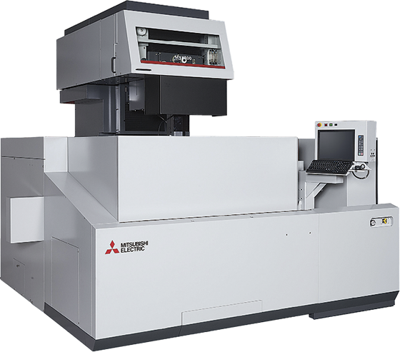

The Mitsubishi MV4800 wire EDM is capable of submerged cutting up to 20 ” deep with the support of an auto-threading system.

Evansville Tool & Die purchased an MV2400-ST and an MV4800 from Innovate Technologies Inc., a Mitsubishi distributor in St. Charles, Ill. The MV2400-ST has X-, Y- and Z-axis travels of 23.6 “, 15.7 ” and 16.5 ” (599.4mm, 398.8mm and 419.1mm), respectively, is capable of submerged cutting up to 16.5 ” deep and can handle a workpiece up to 41.3 ” wide × 32.3 ” deep × 16.3 ” high (1,049mm × 820.4mm × 414mm). The MV4800 has X-, Y- and Z-axis travels of 31.5 “, 23.6 ” and 20.1 ” (800.1mm, 599.4mm and 510.5mm), respectively, is capable of submerged cutting up to 20 ” (508mm) deep and can handle a workpiece up to 53.1 ” wide × 43.3 ” deep × 20.0 ” high (1,348.7mm × 1,100mm × 508mm).
