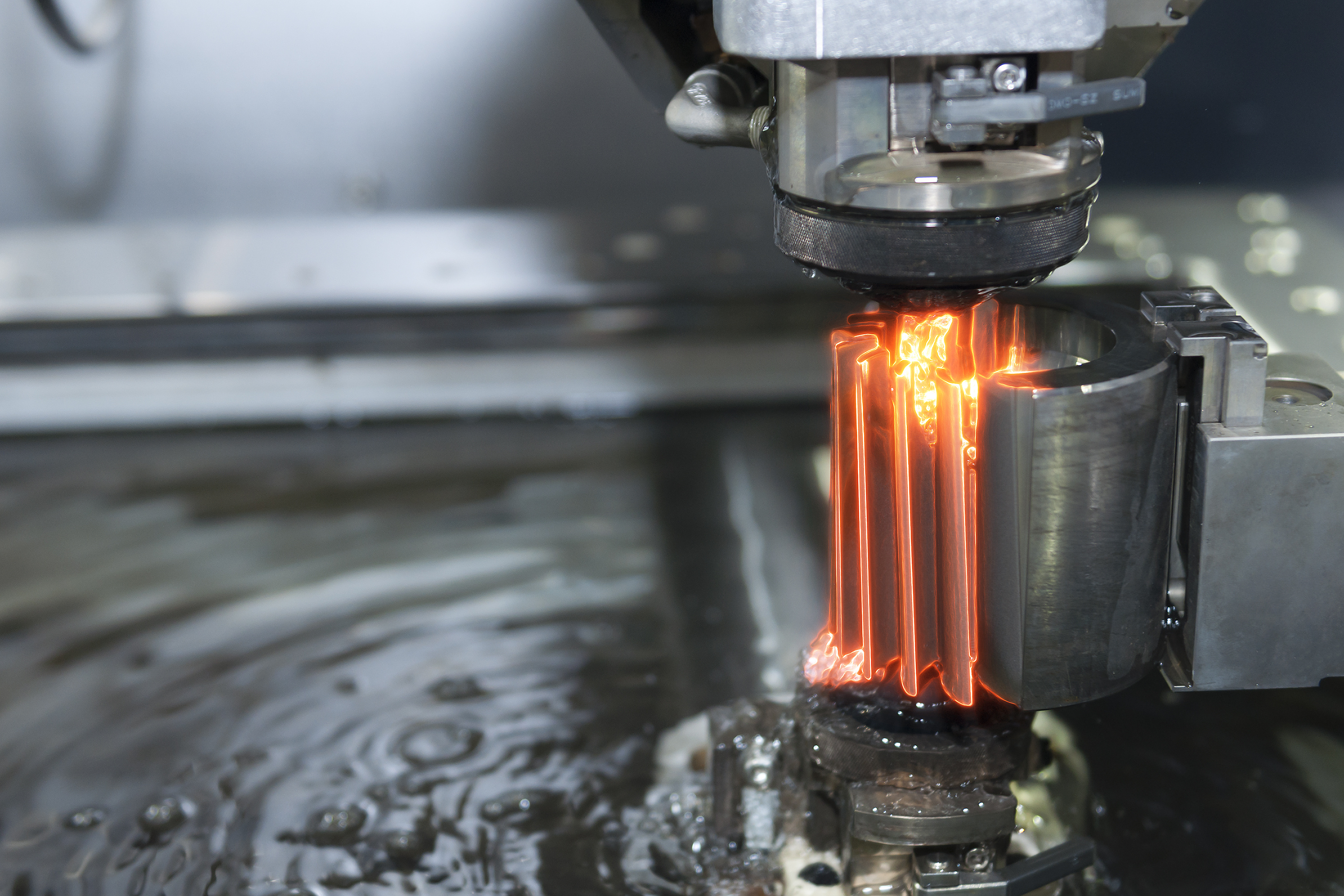

EDMing is sometimes called spark erosion machining, and toolmakers routinely use the word “burning” to describe what happens in the machine. The process removes material with an electric arc. The system has two electrodes, one of which is the workpiece, and the other is the tool. The work area is submersed in a dielectric fluid that electrically insulates the components from each other. A high-voltage charge is applied to the tool, causing the dielectric properties of the fluid to break down until an electric arc is created between the tool and workpiece. Material from the tool and workpiece is melted and carried away by the fluid, thereby generating the cutting action.

Wire-type EDMs use the same technology and physics as ram machines. Although the cutting action of the arc and the flushing of the work zone are much like ram-style machines, the tool is different. Wire machines use — as you probably guessed — a wire electrode. Wire machines are CNC-controlled and programmed like machining centers. A small-diameter wire is driven along a programmed path, and the arc between the wire and the workpiece generates a small kerf along the path. Wire is consumed during the process as the wire continuously is unspooled and fed through the cut zone while traversing the programmed path. Wire cutting is used when there is no need to leave a cavity in the workpiece. Making complex punch and die sets is a common use of wire EDMs.

EDMing processes have numerous advantages, and accuracy is the most significant. Unlike conventional machining, which relies on contact between a tool and workpiece to form a chip, EDMing is noncontact. Because the cutting action is completed without contact between the component and tool, no pressure is exerted on the tool, workpiece or machine. No contact means no deflection, so only a few variables can introduce errors into the cutting path. The result is an extremely accurate process. Working to 0.0025 mm (0.0001″) tolerances with EDMs is routine.
