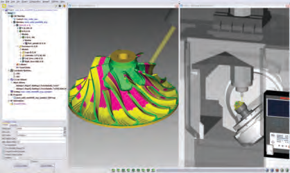

CGTech’s VERICUT software performs 3-D simulation of an impeller being cut on a Mori Seiki NMV 5000 5-axis vertical machining center.
As machine tool and part design complexity grows, part program verification using CNC machine simulation software has become an essential tool for ensuring NC programs machine the part correctly the first time. Skipping the verification step risks costly production delays where the machine tool waits while NC program errors are corrected.
VERICUT is a software program that interactively simulates and displays the material-removal process of an NC program. NC programmers use the software to verify the quality and accuracy of their NC programs while VERICUT’s 3-D machine simulation checks for collisions. But the goal of simulation is not simply a collision-free and efficient NC program. The first and most important goal is verifying that a program produces the correct workpiece.
The simulation software’s in-process model tells a programmer whether or not his program makes a correct part. For example, many NC programs incorporate circular interpolation. VERICUT emulates the circular motion and creates an as-machined cylindrical feature that can be measured to ensure its correctness. This is in contrast to internal simulations that do not emulate circular motion, but instead divide that motion into a series of linear motions approximating the cylinder. These segments are not measurable as a cylinder.

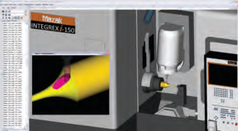

Simulation is performed on a Mazak Integrex i-150 machine using CGTech’s VERICUT software.
Adoption of complex machine tools is a similar example. A few years ago, two-spindle, twin-turret mill/turn CNC machines were not common. Today, many manufacturers utilize multitask machines with multiple tool and part-mounting stations on various motion axes, all crammed into a relatively small space. The chance for collisions between machine components, tools and parts is high when several things move at once. Therefore, enhancements were added to the simulation software to support these machines during their introduction.
