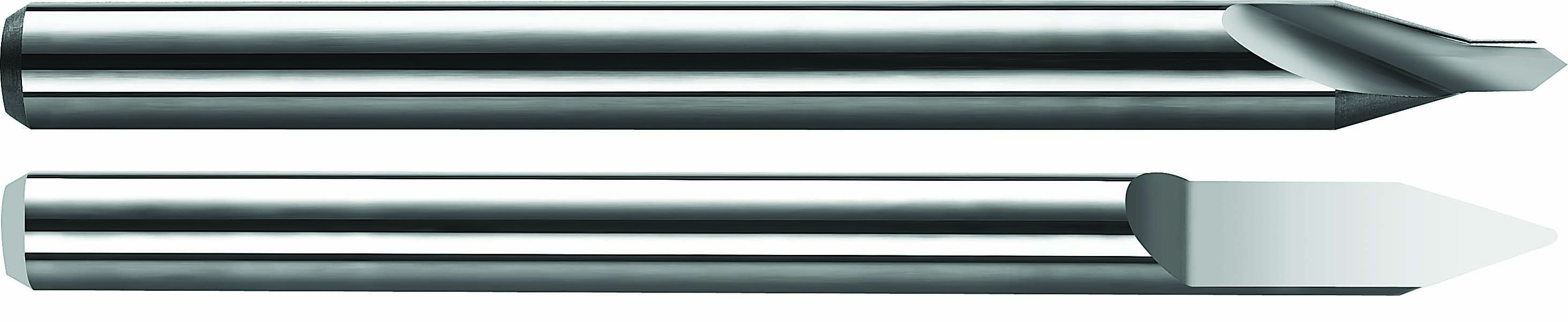

Practically any engraving tool—as well as many small endmills—can generate a 2-D data matrix bar code, according to Nelson. “Most machine shops can get just about anything to work, but you will have the best results if you use the right tool for the job,” he said.
With that in mind, 2L developed the Data Matrix Tool to create such bar codes. The multifaceted, pyramid-shaped tool is made of ultrafine, submicron-grade carbide for achieving long life when engraving 2-D data matrix bar codes and other information in most materials, the company reports. Nelson explained that the tool has a 120° included angle, which is the optimal angle for a scanner to read a 2-D data matrix bar code’s dots, or cells. Essentially, that angle maximizes the contrast between the bar code and the workpiece surface, allowing even inexpensive scanners to read the data. But, “you could pretty much use any tool if you have one of the better scanners,” Nelson said.
Courtesy of Kyocera Micro Tools
Kyocera Micro Tools recommends a multiple-flute cone tool when engraving 2-D data matrix bar codes in hard and casehardened materials.
Although not required, 2L recommends using its spring-loaded engraving toolholder when applying a Data Matrix Tool. With that arrangement, a spring pushes the tool bit against the workpiece, enabling the engraving of consistent dot sizes and depths—even when the workpiece surface is uneven, such as on a casting, or curved, Nelson explained. “The benefit of that is you don’t have to know exactly where the surface is,” he said. “The dots need to be consistent in size; otherwise the bar code scanner will have a hard time reading them.”
In addition, the spring-loaded holder allows feeding the tool at as high a rate as the machine can go, thereby reducing cycle time. For example, a 2-D matrix bar code might take 30 seconds to engrave with a spring-loaded holder compared to 2 minutes when using a rigid holder, Nelson noted. “If you’re doing prototyping, I don’t think anybody really cares,” he said about the cycle-time reduction. “But if you’re making thousands of parts like in the automotive industry, then it’s a big deal.”

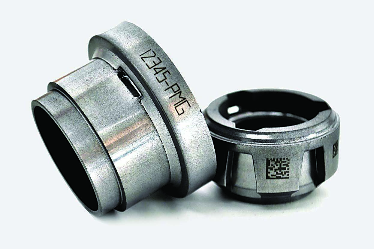

In addition to engraving 2-D data matrix bar codes in a CNC machine, they can be produced with direct part marking (DPM) systems. For DPM, Technifor USA, Charlotte, N.C., manufactures micropercussion and scribing equipment, as well as laser marking machines.
Pneumatic and electromagnetic machines are available for micropercussion marking, which is similar to dot peening, where individual bar code cells are impressed into the workpiece material, noted Alex Boffi, business applications manager for Technifor.
Scribing also leaves an impact mark on the work surface, but achieves it through a dragging action across the surface. “The resulting cells are commonly rounded and match the conical shape of the carbide stylus,” Boffi said of both methods.
Courtesy of Technifor
Micropercussion (top) and scribing systems are suitable for marking parts with 2-D data matrix bar codes and other information.
According to Boffi, the DPM machines provide flexibility, enabling bar codes to be produced in a range of scenarios, from a manually loaded benchtop machine to one in the middle of an autonomous line that relies on computer logic for operation. “It’s completely automated, requiring no human intervention,” he said.
Although a laser can mark a bar code in less than 1 second, a micropercussion system might require 20 seconds, depending on the code size, workpiece material and type of equipment, Boffi noted. “We specialize in very fast machines.”
Marking a curved surface with a DPM system can be a challenge. The marking plane is tangent to the curved surface and therefore cells at a distance from top dead center of a round tube, for example, can be elliptical or elongated and not the specified size. “In scenarios like that, we always recommend formatting the code in a rectangle if we feel that a square code will be compromised on either end,” Boffi said. “[Using a rectangle] results in cells that are directly over as flat a marking plane as possible.”
Regardless of the technology used to create a 2-D data matrix bar code, Boffi emphasized the advantage of having a mark with redundant information. “If you put down an eight-digit alphanumeric code and that part gets scratched or damaged in any way, it could result in the code not being read,” he said. “Despite the possibility of partial damage, a 2-D data matrix bar code can be read.”
And unlike a code that’s stamped or painted on a part and can smear, wear or rub off and become unreadable, an engraving remains crisp and readable, according to Micro 100’s Newberry. “Engravings are permanent.” CTE
