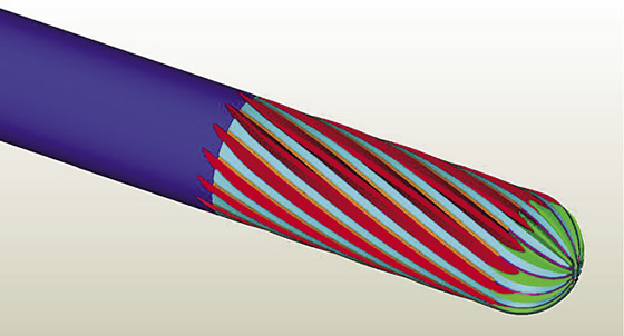

Part manufacturers can increase feed rates when applying tools with a high number of flutes.

If a 6-flute tool with the same parameters is used instead, the following values are generated: 3,820 rpm and 91.68 ipm. This reduces cut time for the circle to 12.35 seconds.

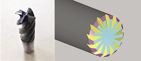

Courtesy of C. Tate
A ½” endmill (left) makes a shallow cut while exhibiting unfavorable tool life, and cycle time requirements do not allow a reduction in cutting speed as it would reduce the feed rate. The tool on the right solves the problem, because the design allows a 60 percent reduction in cutting speed and a 4-ipm increase in the feed rate. This significantly increases tool life while slightly reducing the cycle time.
Besides the cycle-time reduction, another important consideration is the improvement in tool life. In this example, the volume of material being removed doesn’t change because the DOC isn’t altered. Because the volume of material removed is constant, tool life would increase because the work is being distributed over six cutting edges instead of four.
