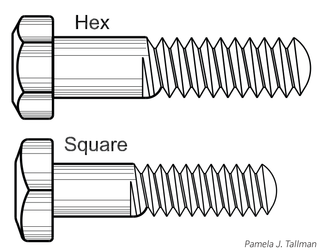

Courtesy of Pamela J. Tallman
Machine bolts.
A variety of threaded fasteners are available, including machine screws, machine bolts, socket head cap screws and bolts.
• Machine screws are made in a variety of head shapes, drive styles and materials. They are available as small as 0.021 " in diameter to ½ " in diameter and in lengths from 1⁄8 " to 3 ". Many people call bolts from ½ " to ¾ " in length screws, but that is technically incorrect.
• Machine bolts are most often available in hex or square head styles in diameters from ½ " to 30 ". Mating nuts are available for them. Dimensional control on machine bolts makes them suitable only for rough work.
