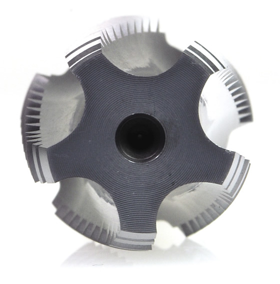

The face of an interrupted-thread tap shows the rake angle and enlarged size of the flutes for enhanced chip evacuation.

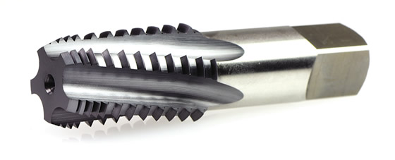

Taps are available with interrupted threads in straight- and spiral-flute designs, and with a variety of tap coatings.

Interrupted-thread, tapered-pipe taps can combat these problems because they reduce flank friction, permit better lubrication and allow more room for chip removal.
To create the interrupted thread, the toolmaker removes every other thread profile behind the chamfer on the tap, creating big gaps on the tool. “Interrupted-thread taps reduce friction and increase chip load because every other tooth is removed axially along the length of the tool,” Morrison said. “This causes each tooth to create a chip roughly twice as thick as it would be before, which typically creates better chip formation conditions in softer materials. Chip removal also is usually better due to the creation of a short, broken chip.”
The chamfered portion is left with full threads to ensure the tap starts accurately and guides the rest of the tool along the correct path in the hole.
“The skip-tooth geometry is suited to materials that have a compressive force, elastic memory or gummy condition,” said Mark Hatch, product director of taps and threads mills at Emuge. “These tend to be sticky materials that clog the tool flute, like low-carbon steels, 1018 steels, 1020 steels and 300 series stainless.”
