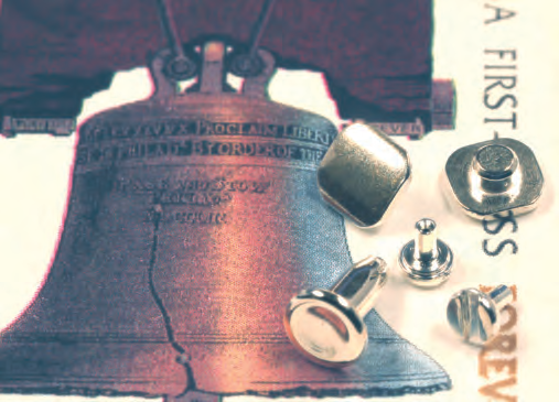

Courtesy of Deringer-NeyCold-formed electrical contacts made from silver alloys and silver-plated copper.Cold forming is a fast, chipless way to make parts.Clack-tick-clack-tick-clack-tick-clack-tick. That's the sound of a six-die, cold forming machine spitting out parts at rates up to 200 pieces per minute.

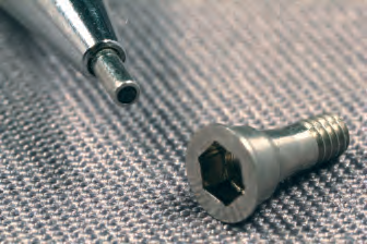

A cold-formed dental screw.
At its Marshall, N.C., plant, Deringer-Ney specializes in forming microparts, including antenna leads; actuator pins; medical-grade, implantable, radiopaque markers; and miniature screws for medical and electronic devices. It forms standard and high-value work materials, including gold, platinum and tantalum.
Deringer-Ney regularly cold forms parts with dimensions down to 0.25mm—only three times the width of a human hair.

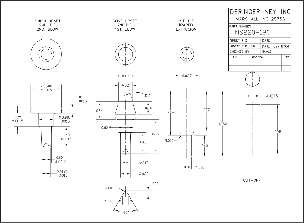

A blueprint of a cold-formed part made by Deringer-Ney shows the sequence of operations.

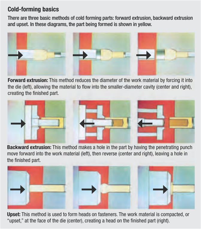

Cold-forming basics
There are three basic methods of cold forming parts: forward extrusion, backward extrusion and upset. In these diagrams, the part being formed is shown in yellow.
