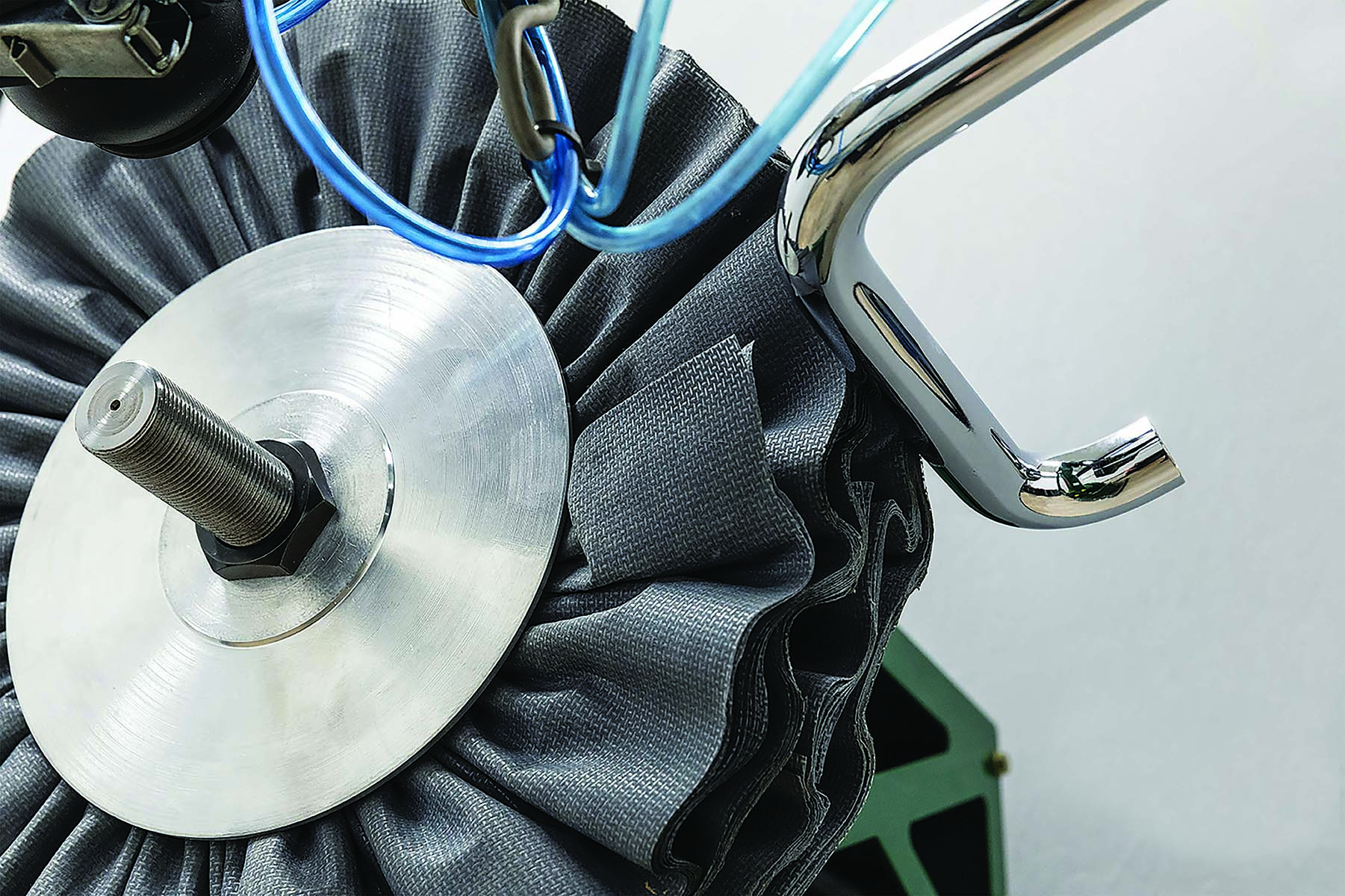

A FAB wheel buffs a faucet part.
A FAB wheel buffs a faucet part. Image courtesy of Norton | Saint-Gobain Abrasives

Another finishing tool that the company offers is Norton FAB (which stands for fixed abrasive buff) buffing wheels. FAB wheels have silicon-carbide abrasive grains, which are controlled tightly for shape and particle size distribution, on both sides of the nonwoven cloth, reducing the amount of buffing compound consumed by 50% to 90%, according to the company.
Some compound still is needed for cooling purposes.
“You don’t want to overheat the part since it’s nearing its final form,” Bonner said. “You use a little bit of compound or, in some cases, just water.”
She said the reduction in compound means that less time is needed to clean up leftover compound material after cut buffing and that maintenance and waste disposal costs are lower. Less compound consumption also improves worker safety because not as much compound material is sprayed around work cells. The compound may contain petroleum or fatty acid components, which can be combustible.
“The less of the compound you use,” Bonner said, “the less inventory and the less combustible material you need in your shop. That’s a benefit.”
Another benefit is an approximate 35% increase in the life of a FAB wheel compared with a conventional cotton buffing wheel, the company reports.
When performing semi-automatic and automatic buffing, Bonner said the machines usually have variable-speed drives, which allow more process control.
“We like to reduce the speed when the FAB wheel is used versus a regular cotton buff,” she said.
Bonner noted that FAB wheels function effectively at a speed from 762 to 1,067 m/min. (2,500 to 3,500 sfm), which is up to 50% slower than the speed for a cotton buff. The slower speed does not generate as much heat in the part and helps prolong wheel life.
She said FAB wheels impart single-digit microinch Ra measurements.
“You have a good, consistent finish when it’s being used and no stray scratches or random defects,” Bonner said.

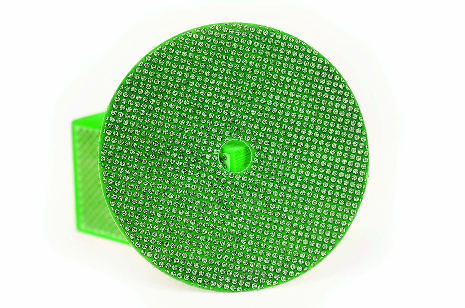

A Genesis diamond disc and hand pad is suitable for polishing composites.
A Genesis diamond disc and hand pad is suitable for polishing composites. Image courtesy of Abrasive Technology

Abrasive Technology also offers diamond products for finishing composites.
“In these what I call finishing operations, we’re seeing more opportunity on the composite side than on the metal side,” Namola said, adding that areas of growth include wind energy and land transportation.

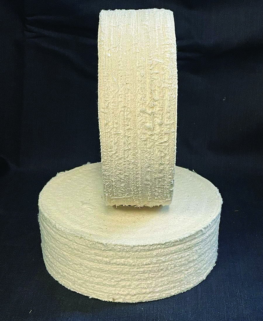

Clothflex polishing wheels are headed with hot glue or cold cement and rolled into a loose abrasive.
Clothflex polishing wheels are headed with hot glue or cold cement and rolled into a loose abrasive. Image courtesy of Divine Bros.
He noted that the Genesis line of diamond discs, belts and orbital pads was developed for the stone markets, but the company made adjustments to manually finish a variety of composites, including fiberglass-type materials and carbon-fiber composites. Previously, the single-layer version of that product stopped at 600 mesh, but Abrasive Technology expanded it to 3,000 mesh in increments of 800, 1,200 and 2,400 mesh. Previously, these finer sizes were available only in a resin-bond system, which would not work on composite materials.

For polishing purposes, one product that the Utica, New York-based company manufactures is the Clothflex polishing wheel. The wheels are used for flexible belting of primarily castings and part contours, said Regional Sales Manager Ryan Sessions.
“It’s not uncommon for them to be coated with a glue and grit mixture to create a quasi-grinding wheel, depending on the parts that need to be finished,” said Regional Sales Manager Lyndon Posch.
When headed with hot glue or cold cement and rolled into a loose abrasive, the factory-balanced wheels run true. When the abrasive is spent, the process can be repeated after freshening the wheel’s face. This results in long wheel life and productivity gains, the company reports.
Customers purchase the adhesive and grit, which Divine Bros. also produces, based on finishing specifications and apply the mixture with a brush, putty knife or spatula, Sessions explained. The mix commonly is placed in a warm oven and allowed to cure for about 24 hours. Other customers use a jig setup.
“One of our bigger customers is doing 15 to 20 pieces at a time in a jig,” he said.
Sessions said the number of coats, or layers, applied varies from a couple to nine or more.
“A lot of places have tried-and-true systems,” he said, “and nobody does it the same.”
Posch said the wheels are reusable and that the abrasive can be altered to suit specific applications. For example, an 80-grit wheel can be used until a part run is completed and then the remaining grit is removed, at which point a 150- or 240-grit abrasive is applied.
“It allows you to be a bit more versatile,” he said.
All the wheels consist of layers of cloth that are glued and compressed together, but different stitching enables the cushion to be soft, medium or hard, said Regional Sales Manager Brian Hotchkiss. A soft wheel might have stitching every 19 mm (3/4″), a medium wheel’s stitching might be from 9.5 mm to 12.7 mm (3/8″ to 1/2″), and a hard wheel will have close-knit stitching of 3.2 mm (1/8″).
“It gives you different feels of cushion on the face of the polishing wheel depending on the amount of contour and the shape of the part that you need to polish,” he said.
