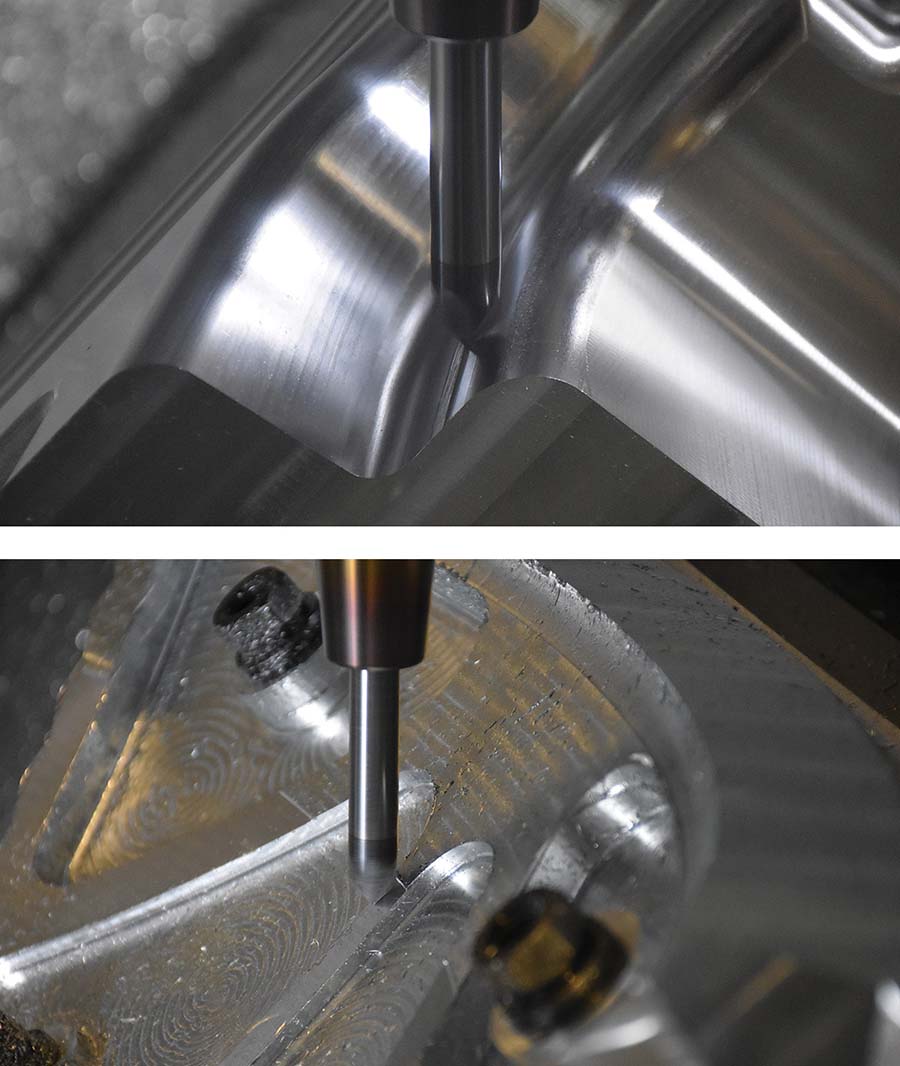

A circle segment endmill delivers a precision finish while reducing machining time. Image courtesy of CNC Software
Finishing is an active area of CAD/CAM software development that becomes better every year regarding how software supports tools, tool geometries, control strategies and tool libraries. The technology was developed in conjunction with innovations in advanced cutting tool shapes, including oval form cutters, barrel mills, taper cutters, lens-shaped cutters and combination lens-barrel form tools.

From a technical perspective, improving surface finish quality is all about reducing cusp height. That is the deviation and looks like little waves on the surface that a tool leaves when it removes material. A smaller cusp height yields a better surface finish. Typically, to reduce cusp height, a larger-diameter tool is needed. This methodology uses a tool of small diameter with a large effective cutting radius on specialty profile. This allows a user to reduce cusp heights while increasing the step-over, thereby increasing surface quality while not forcing the use of a large-diameter tool. The secret to successful use of these tools is maintaining proper tangency of the cutting radius to the surface being cut.
