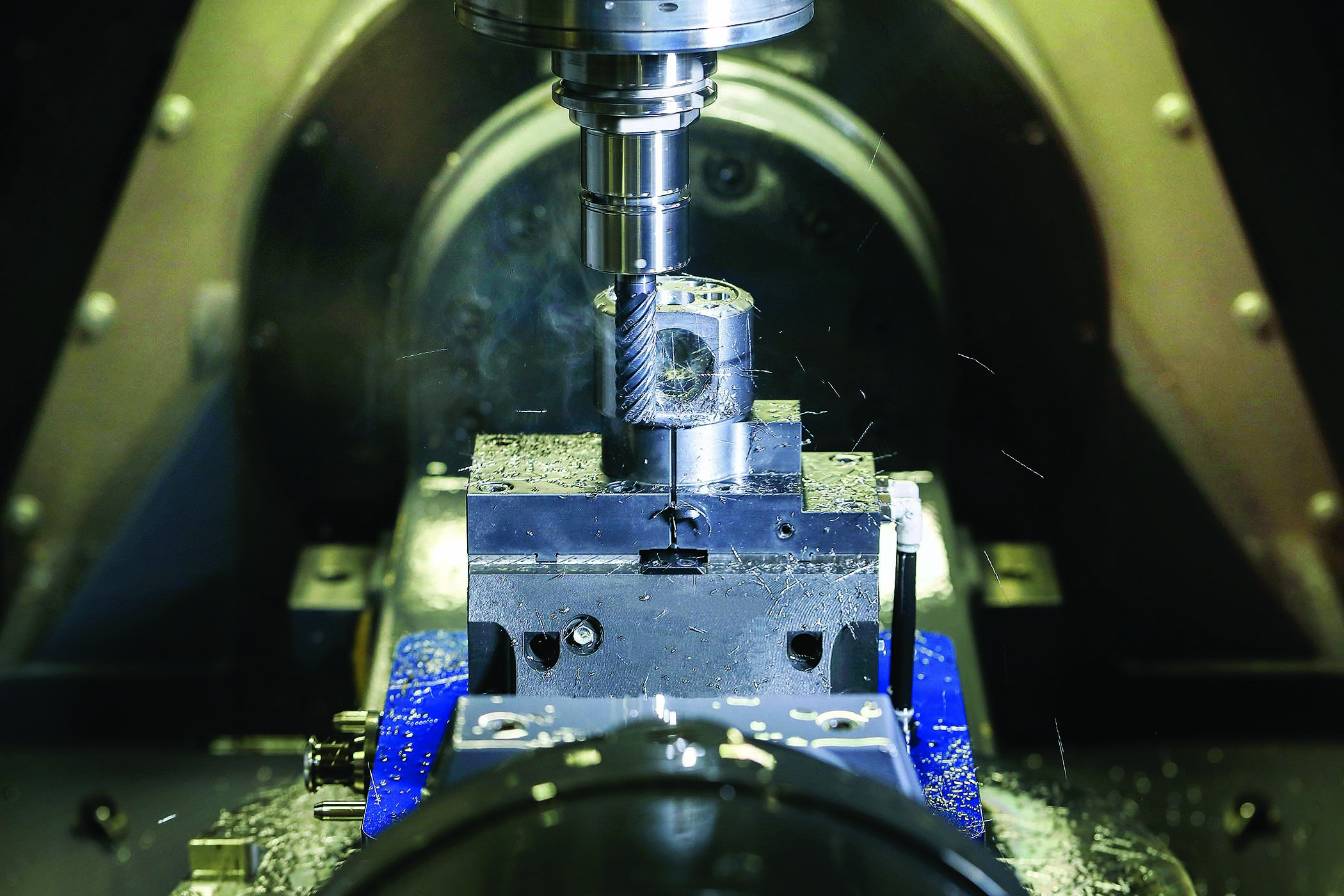

One critical consideration is rigidity of the entire toolholding assembly from the machine spindle to the tool tip. The most rigid toolholder type remains the endmill holder, according to Frank Fullone, general manager of Lyndex-Nikken Inc. in Mundelein, Illinois. Unfortunately, an endmill holder is not conducive to maintaining a low total indicator runout, another key consideration.
That “old technology” design requires tightening a lock screw on a flat or Weldon shank to securely clamp the cutting tool, explained Michael Herman, vice president of sales for BIG DAISHOWA Inc. in Hoffman Estates, Illinois. Tightening the screw elliptically pushes the tool off center in the holder. “That gives 100% security for the tool not coming out, but it’s probably the worst-case scenario as far as the TIR on the tool.”
Big Daishowa
BIG DAISHOWA reports that its Mega New Baby collet chucks provide excellent clamping and runout accuracy, and have a positive impact on part quality, surface finish, tool life and machine utilization. Image courtesy of Big Daishowa
The next option is a milling chuck, Herman said, which is a mechanical chuck with needle bearings pitched at a slight angle. The runout is less than 0.01 mm (0.0004″) at four times diameter.
He added that another measurement for TIR is made at the face of the collet. “Generally speaking, if you improve TIR by 0.001″, you’re improving your tool life and your cost by 10%.”
For high-speed applications, the toolmaker offers Mega New Baby collet chucks, which provide excellent clamping and runout accuracy, according to Herman. The company reports that every collet is inspected twice to guarantee runout accuracy of 0.0004″ at the collet nose and 0.00012″ at four times diameter.
A shrink-fit holder provides a high degree of tool security, Herman noted, if the tool shank is ground to the correct H tolerance. For example, a shank that is ground undersized slightly will reduce the clamping pressure, or gripping force — another key consideration.
“Ultimately, the best choice is a hydraulic chuck,” he said, “and that is also the best because it gives you some dampening effect. It’s a very easy solution for an operator to mechanically tighten the screw, which compresses the bladder 360° around the tool itself.”

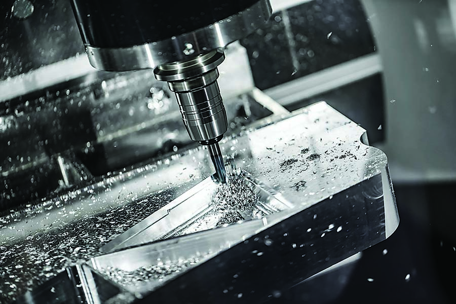

A toolholder’s balance is another key consideration but some people discount it, according to Fullone. “The common comment that I’ve heard in my 30-plus years is that a balancing machine doesn’t make a chip, and they don’t understand the validity of it. It’s the same comment that’s made about presetting.”
ISCAR USA
HELI-GRIP double-sided inserts have a twisted design to groove deeper than an insert’s length, and the CUT-GRIP family provides a large variety of inserts for grooving and turning. Image courtesy of ISCAR USA
The importance of balancing a toolholder assembly is that it increases the longevity of spindle bearings and improves a part’s surface finish by minimizing vibration, he added. To achieve a balanced assembly after spinning it in a balancing machine to locate any potential imbalance, end users remove weight such as by milling flats, add weight such as inserting screws along the flange of the toolholder or use some other method such as balancing rings.
Because a cutting tool weighs considerably less than a toolholder, which is factory balanced, Fullone conceded that inserting a tool into the holder can have minimal impact, depending on the type of tool, tool construction, number of tool components and its mass. “If it’s a ½” endmill, assuming that the holder is going to run at 15,000 or 18,000 rpm, it’s not going to affect the balance in most cases. You can’t say never, but in most cases you’re still fine with the factory balance.”
Herman noted that a holder assembly can be perfectly balanced, which might require the addition of weighted screws or milling flats to remove material, and then the balance is off once a different tool is inserted. “How much do you want to chase after that. Our tools are balanced during our manufacturing process. We use ground threads and ground nuts without flats.”
He contrasts the ISO 1940-1 balancing specification, which was developed in 1940 and is primarily considered “old school” for this reason, to ISO 16084, which was issued in 2017 and the specification that BIG DAISHOWA toolholders are balanced in accordance with. ISO 16084 focuses on the interaction between the spindle and the tool, factoring in the allowable load on the spindle bearings generated by the tool’s imbalance. This load must not exceed 1% of the dynamic load of the spindle bearings. According to ISO 16084, the allowable unbalance tolerance is specified in gmm and not the special quality grade of G.
BIG DAISHOWA does not indicate any G values for balancing quality, Herman added, but rather the maximum rotational speeds of the individual toolholder. These values are in compliance with the requirements for standard balance quality as per ISO 16084.

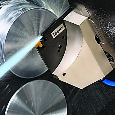

Because some machining operations require that the workpiece rotates while being cut by an insert held in a tool body, different considerations arise than when a rotating tool cuts a stationary workpiece. “In a part off application, we’re concerned with the balancing or the center height of the tool itself,” said Robert Navarrete, national product specialist – parting, grooving and turning for ISCAR USA in Arlington, Texas.
ISCAR USA

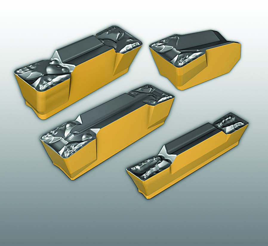

The LOGIQ-F-GRIP system for parting and grooving has a reinforced block that enhances support from the bottom and back and effectively distributes cutting forces. Image courtesy of ISCAR USA
In parting, the goal is for the tool to be at center or above center because cylindrical forces push the insert down once it engages with the workpiece, Navarrete explained. The formula to calculate ideal center height is 0.787 mm (0.031″) times insert width plus (0.0254 mm) 0.001″ equals the maximum height above center. When an insert is below center, edge strength is lost. If the cutting edge is 0.254 mm (0.010″) below center, a 17% loss in edge strength results.
Similar to other machining applications, a rigid holder setup is important for success, enabling a straight cut, a fine surface finish and increased productivity by either boosting the feed rate or the cutting speed, Navarrete noted. To help end users achieve that, ISCAR offers the LOGIQ-F-GRIP system for parting and grooving, which has a reinforced block that enhances support from the bottom and back and effectively distributes cutting forces.
He added that LOGIQ-F-GRIP is a bulkier holder but is available in common square shank sizes that will plug into a standard tool station. “This is still a plug-and-play toolholder that will fit into any machine.”
The way the insert pocket is designed uses rotational forces to push the insert into the pocket rather than lifting it out, Navarrete explained. The design also ensures consistent pocket wear over a long period of time. In contrast to the company’s original jaw-style clamp to secure an insert, the new design does not cause the insert to bounce at a microscopic level, leading to premature wear and preventing full insert contact.
In a test that compared the original-style pocket to the LOGIQ-F-GRIP’s pocket, he said the original version completed 3,000 interrupted cuts before the pocket was worn while the LOGIQ-F-GRIP completed 7,000 interrupted cuts and the pocket appeared barely used. “So, we stopped at 7,000 because we proved our point.”
Navarrete emphasized the importance of paying attention to the wear pattern of the pocket because it is challenging to predict pocket life on the number of parts as it depends on the machining environment and metal being cut. The LOGIQ-F-GRIP’s quad blade, or adapter, has four pockets. “You’re going to be able to rotate that adapter four times. You buy one adapter; you’re getting four ends.”
