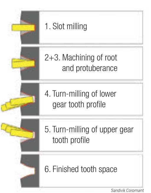

The steps for cutting a tooth space with the InvoMilling process. Illustration courtesy Sandvik Coromant.
InvoMilling is targeted for prototyping and producing small to medium batches, while hobs, especially ones that accept carbide inserts, are more productive and suitable for larger runs. The appropriate part quantity depends on part complexity, which might include a key slot, holes and threads in addition to integrated gearing. “What you would lose in the gear cycle, you could potentially make up by doing everything in the same setup,” Bylund said.
When InvoMilling a tooth space of an outer spur gear, for example, a groove is first axially milled. The workpiece then slightly rotates as the cutter plunges for the final two cuts. The process can impart a surface finish as fine as 2µm Rz from root to tip and produce a DIN 6-class gear, the company reports. Similar to hobbing, a gear is heat treated after InvoMilling before finish grinding.
