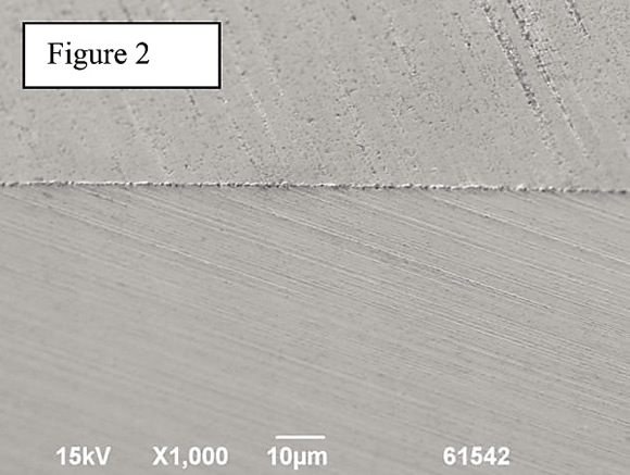

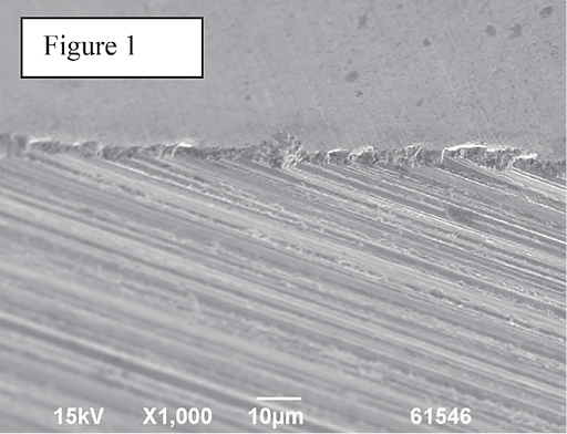

The flute face and cutting edge of a cutting tool before (Figure 1) and after (Figure 2) applying a Norton fine-grit, hybrid resin-bond grinding wheel during the flute polishing process.

According to Kenneth Saucier, senior corporate applications engineer for Norton/Saint-Gobain, who developed the Norton flute polishing process, a flute surface has three major components: aesthetics, surface roughness (as measured in Ra) and surface integrity. “It is possible to get a very appealing finish but a poor cutting edge,” he said. “Using a fine-grit grinding wheel will allow you to achieve all three attributes.”
Niagara Cutter applies 1,000-grit wheels for flute polishing to enhance surface—and therefore cutting edge—integrity and aesthetics by imparting a mirror finish, although it does not target a specific Ra value. “A jagged cutting edge is typical without the Norton process on standard tools,” Lundy said.
The polishing wheel requires special truing wheels for rounding and profiling and 800-grit aluminum-oxide dressing sticks for exposing fresh diamond particles. Lundy emphasized the importance of maintaining open truing and grinding wheels when truing, a condition determined by operator touch during setup. “A standard operator is not going to experience success without some help,” he said. “The process has to be perfect.”
