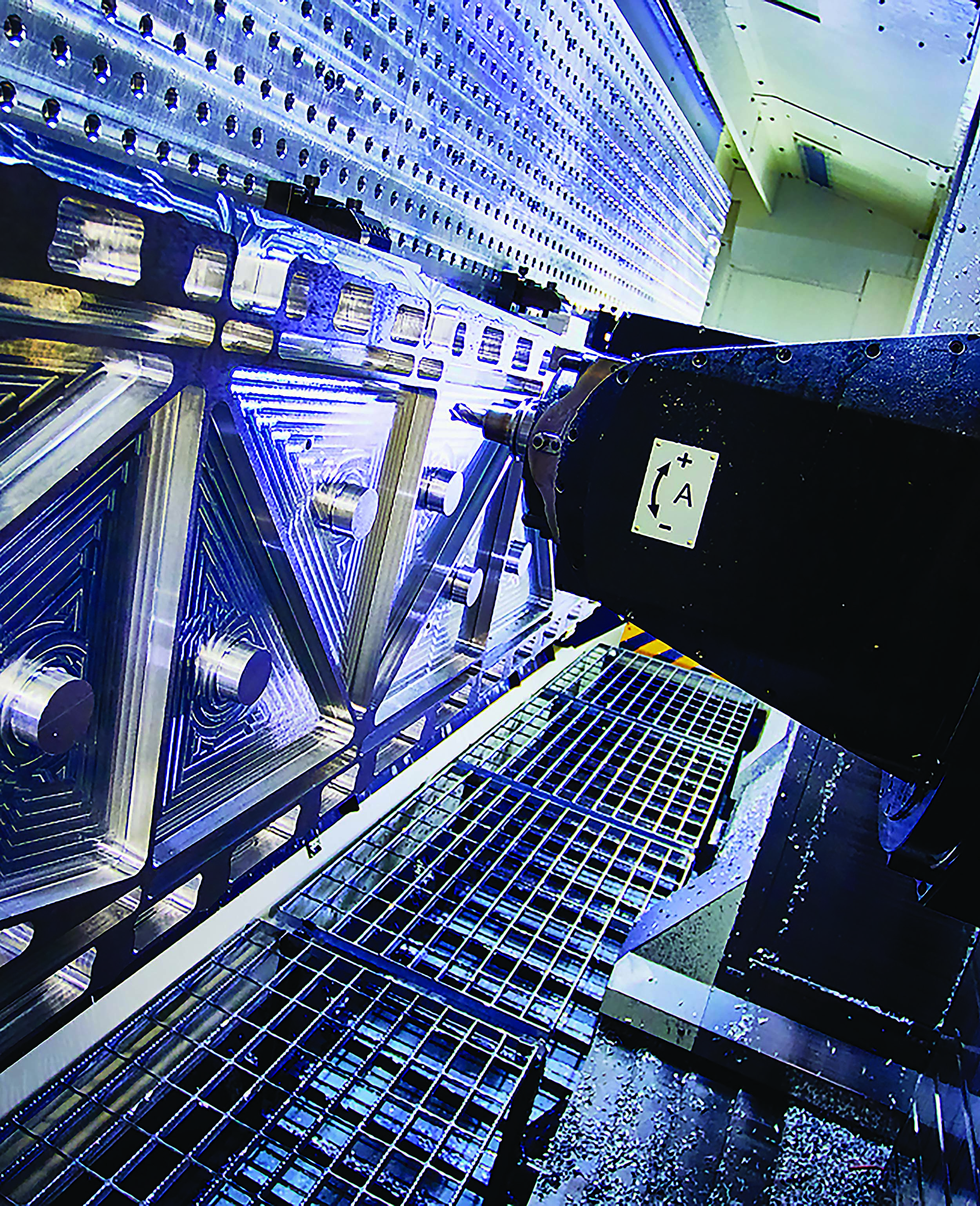

In addition to jet engine components, aerostructures are also produced on 5-axis machines. Image courtesy of Makino

Lippert said Makino divides aerospace production into two types of parts: aerostructures and for the jet engine portion. The former includes wings, fuselage, cockpit area, tail section and landing gear, while the latter includes blisks, impellers, single blades and vane segments.
HMCs are more suited for aerostructure requirements, and the company’s 5-axis horizontal equipment starts at 1.5 m (59.1″) and goes up to 20 m (787.4″), he said. “The hard metals side really only goes up to 5 m, but the aluminum side goes up to 20 m in a horizontal, 5-axis configuration.”
When machining aerostructures, such as beams, bulkheads, spars and ribs, or “intercostal” parts, at most 10% of the features require full simultaneous 5-axis motion, according to Lippert. The inverse is true for engine components. “These parts require over 90% full 5-axis motion just to be able to produce the part feature content efficiently and effectively.”
