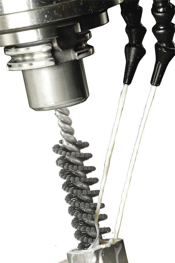

The ball-style tool is characterized by a shaft with small, abrasive globules permanently mounted to flexible filaments. According to the toolmaker, the tool can be mounted in an electric hand drill motor, which is how Sikorsky needed to apply it, or in a machine tool chuck for resurfacing hard metals, ceramics and other challenging materials. The tool can impart surface finishes as fine as 0.1µm Ra.
For Sikorsky’s application, Brush Research constructed the special flexible hone with 170/200 diamond grit. The 0.18 "-dia. tool has an overall length of 6 " and a 2 "-long brush section.
Brush Research Manufacturing’s diamond Flex-Hone tool can be mounted in a machine tool chuck or hand drill motor for finishing or resurfacing hard and difficult-to-machine materials.
