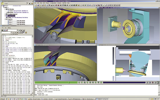

Patrick Delisse, HSM CAM engineer for DutchAero, uses CGTech’s Vericut and OptiPath software to ensure machine tool safety and cutting efficiency.
In addition to the workpiece materials, part complexity has become more challenging for the company. “To produce these parts efficiently, we required more complicated machine tools,” Delisse said. These included a 4-axis Makino machine and a Starrag STC630 machine that can perform simultaneous 5-axis milling.
To confirm error-free programming of the toolpaths to prevent collisions among the machine tool structure, workpiece, workholding fixture and cutting tool, DutchAero needed NC program verification and simulation software. The company selected Vericut from CGTech, Irvine, Calif., because the software is independent of the CAD/CAM system and performs the verification on post-processed NC code.
“The use of Vericut is now mandatory, and no programs are released to the shop floor without first being verified by the software,” Delisse said.
CAD/CAM data comes from DutchAero’s Siemens NX (Unigraphics) software, while Vericut independently verifies and simulates that the toolpaths will run gouge-free and a machine’s axes movements will not cause any collisions.
The latest machines DutchAero installed, a Breton 5-axis mill/turn machine and a Starrag STC 5-axis machine, are used to produce blisks. CGTech’s technical support team provided the virtual model for the Starrag machine tool, complete with details of the CNC system emulation, and the interaction and motion travels of its axes—its kinematics. Breton provided a model of its machine as a Vericut file and Delisse added the control system emulation and machine kinematics.

DutchAero simulates and verifies every NC program with Vericut software before sending it to the shop floor.
The company’s Pietro Carnaghi vertical turning lathe is also modeled in the software. Because the lathe can change cutting heads from horizontal to vertical, DutchAero uses the software to correctly orient a cutting tool and simulate any machining operation the lathe performs. The company models the cutting tool assemblies as accurately as possible with WinTool tool management software for use in Vericut. In addition, the verification software can import models from toolmakers that post cutting tool definitions online, such as Sandvik Coromant.
Delisse explained that he uses Vericut interactively on his computer, running the software line by line until it encounters an error, which is then modified before searching for the next error. Then, he restarts the software and runs the program through again to ensure the edited code is free of problems. “I can usually do this overnight,” Delisse said. “When I come in the following day, the code is all correct and can be issued to the shop floor.”
He added that operators view the simulation files so they know what to expect when they run a new job. “With the trust we have in Vericut, we have minimized on-machine prove-outs,” Delisse said. “The only stipulation for the first-part run is an operator and an NC programmer must be present.”
