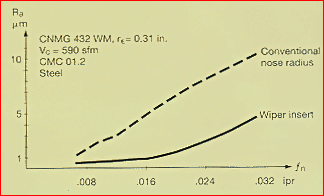

The idea behind all of these inserts is similar. The trailing edge behind the primary cutting edge wipes or smears the wave pattern that is left behind by the quickly moving insert (Figure 2). “The blended radii knock off the high points created by the feed lines,” says Sandvik’s Alig. “This provides a smoother finish without utilizing a larger nose radius or slower feeds.”
Frenzied Feeding
Figure 2: This graph comparing the performance of a wiper insert to that of an insert with a standard nose radius shows how a wiper insert can produce better finishes at various feed rates.
All three manufacturers have designed their wiper inserts to be high-feed tools for use at light DOCs. With their wiper-insert designs, each company has taken into account the higher chipload that is generated at elevated feeds. Iscar’s Gadzinski says the wiper inserts he’s seen have been designed with very aggressive chipbreakers. According to Sandvik’s literature, the chipbreaker on its wiper insert “extends well beyond normal cutting-data limitations.”

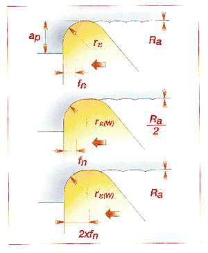

These new wiper designs give machinists a choice. “With a wiper, if you leave cutting data the same, you can achieve a much better surface finish,” says Carboloy’s Goulding (Figure 3). He gives the example of a wiper insert cutting at a feed rate of 0.012 ipr. The operation will produce a surface finish of 15µin. to 18µin. Ra, he claims. Goulding says a standard insert with a 0.030″ nose radius at the same feed rate will produce an 80µin. Ra. “But,” he adds, “you have the opportunity, especially in medium roughing, for example, of doubling or increasing the feed rate but retaining the same surface finish you had before. The benefit there is productivity.” According to Goulding, if the feed rate is increased to 0.020 ipr, Carboloy’s wiper insert will produce a 20µin. Ra surface finish. At that feed, a standard insert produces a finish of 200µin. Ra.
Frenzied Feeding
Figure 3: These diagrams compare the performance of a standard insert (a) to that of a wiper insert (b) and (c). Even though the leading-edge nose radius (re) remains the same, the wiper inserts can produce half the surface roughness (Ra) at the same feed (f), or the equivalent surface roughness at double the feed rate.
