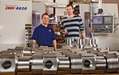

IMCO sales representative Chris Cooper (left) and Jake Aasness at Kline Tools were pleasantly surprised at the IMCO Everyday Advantage endmill’s ability to machine 718 Inconel ball valves (below) eight times faster than other high-performance endmills.
