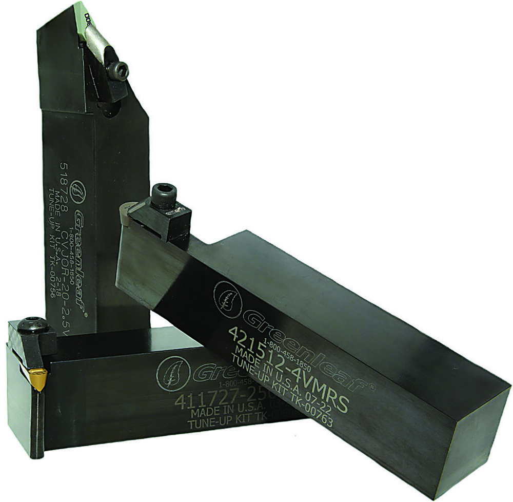

Greenleaf supplies tune-up kits for toolholders that provide all the needed replacement components. Greenleaf

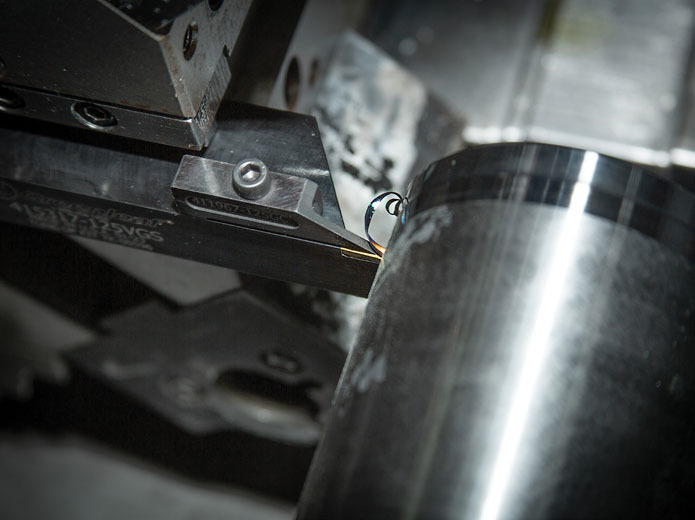

When performing turning operations such as grooving and cutting off, square nose-style inserts are typically used, according to Greg Sage, who is regional product manager of turning – Americas at Kennametal Inc., headquartered in Pittsburgh, Pennsylvania. However, there are limitations with that type of insert. “It doesn’t allow you to be as dynamic with it.”
A more versatile platform, Sage said, is the toolmaker’s Beyond Evolution full radius-style grooving inserts with a greater than 180° cutting edge, which are also able to perform copy turning, profiling, plunging and other operations. “You have the ability to go down, profile back and forth, quickly remove a lot of material and be able to do some fairly complex profiles.”
He added that with a full radius insert, an end user is not necessarily going to do a straight plunge. “You do lead-in angles where you start to radius yourself into the cut. Now, you can then go and do your back-and-forth style of passes, where you are creating that groove or profile into the part.”
That maneuver works best for large areas, Sage explained, and plunging is best when the width is fairly narrow.
The Beyond Evolution inserts are secured with a single clamping screw, he said, making it easy to swap inserts in the machine. “Or you can have redundant tooling. You can have two toolholders set up, one with a square nose insert and the other with a full radius.”
The platform offers multiple different geometries, Sage said, including the company’s grooving universal positive and grooving universal negative geometries. The positive one is suitable for straight plunging and grooving applications and has chipbreaker forms even around the side areas to provide effective chip control in all directions, such as when performing side turning. On the other hand, the negative one offers a high degree of edge strength for applications with a low cutting speed and DOC. “It is specifically made to control chips well whether you are plunging or side turning with it.”

To hold the inserts, Greenleaf offers two different styles of tool bodies, he said. One features a milled nest that holds the V form on the bottom of the insert along with a specific shape, such as a round pocket, to accept the geometry of the insert. The replaceable nest design has a small cartridge that fits into a key onto the holder itself to allow a user to replace the nest portion without replacing the entire holder. “You can replace that if it gets damaged. It tends to be the area that sees the most abuse in a lot of operations.”
In addition to the nest, if needed, Dillaman noted that Greenleaf supplies tune-up kits for toolholders that provide all the other replacement components, such as clamps and screws, to allow users to return holders to nearly new condition. “It gives you all those components that you are able to install on the toolholder instead of having to order each individual component.”
