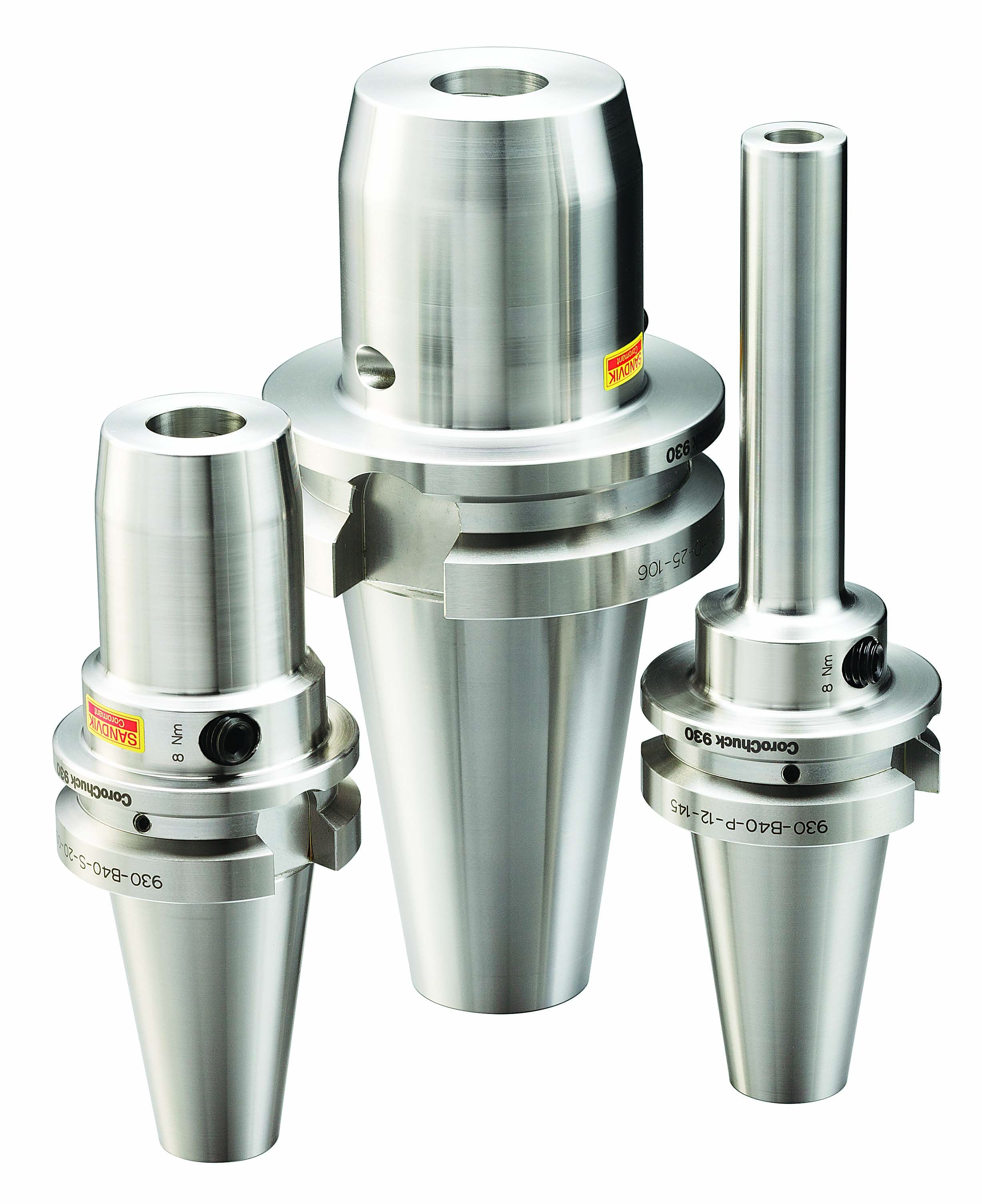

Rigidity, stability and accuracy
The rigidity and stability of a toolholder is critical for achieving precision and accuracy in your machining operations. Toolholders that are not rigid enough can allow tools to move during cutting, leading to vibration, chatter, poor surface finishes and reduced tool life. Look for toolholders made from high-quality steel or carbides that resist flexing and deformation under load. The interface between the toolholder and the machine should also be optimized to maximize stability.
When evaluating the features of a toolholder more closely, there are some key technical specifications to analyze. Runout tolerance provides an indication of potential deviations to expect in the holder’s alignment. This is measured in microns (μm) — lower runout translates to less deflection and higher stability. Static stiffness refers to the holder’s resistance to deflection under load when the tool is not rotating. This is measured in N/mm, with higher values indicating greater rigidity. Dynamic stiffness accounts for deflection when the holder and tool are rotating and cutting. Damping properties are also important, as damped toolholders can dissipate vibration and stabilize chatter. By comparing factors like runout tolerance, static/dynamic stiffness and damping properties, you can better analyze the rigidity and stability different toolholders can provide for your application.

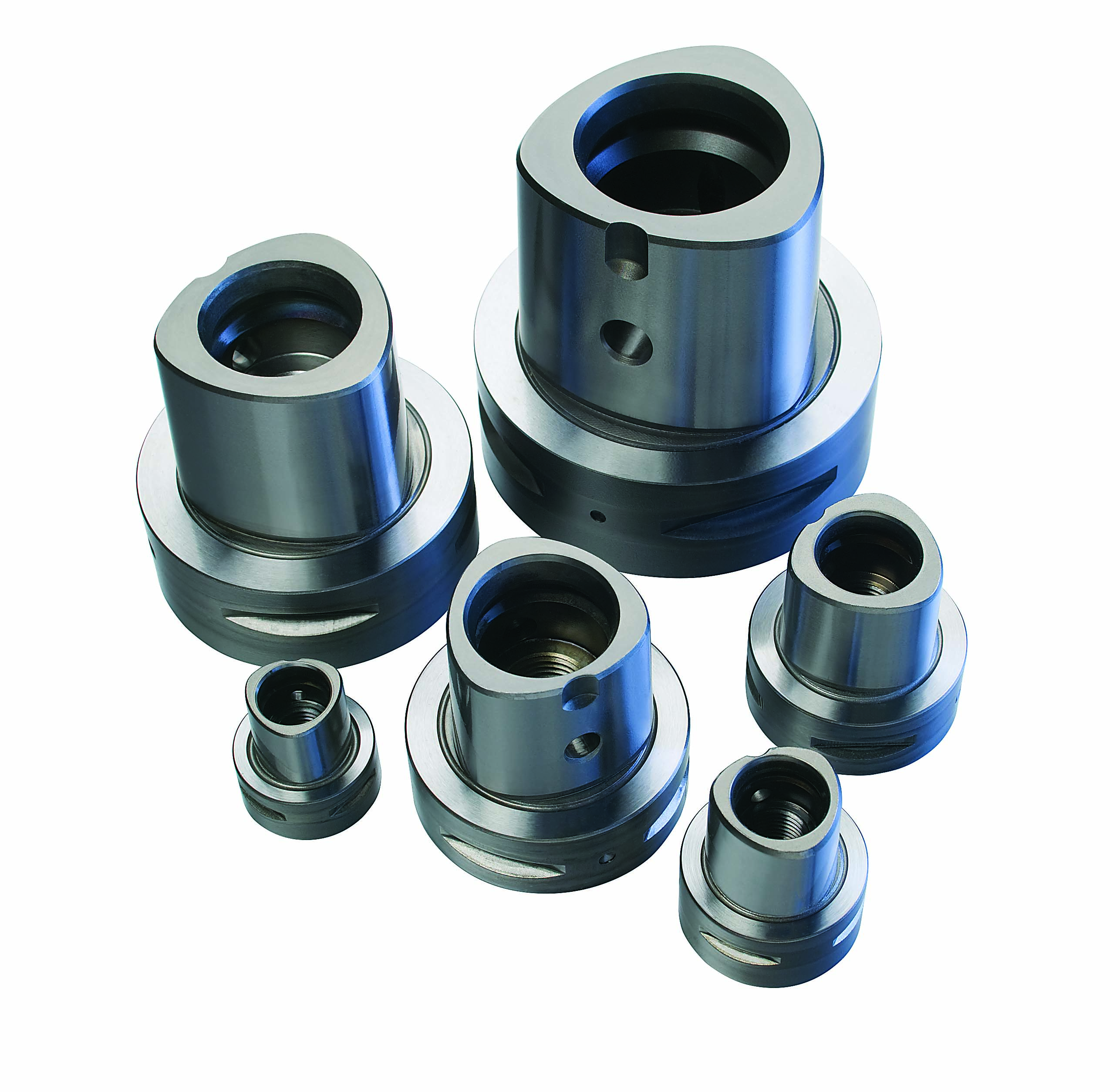

Clamping and grip
The strength of the clamping mechanism is equally important. Insufficient clamping force can allow movement or pull-out of the cutting tool during operation. This leads to poor maintenance of tolerances and potentially dangerous run-out conditions. Choose tooling systems with robust clamping bolts, screws and wedges to keep tools locked in position under high loads and vibration. Hydraulic clamping systems offer very strong clamping capabilities, and automation is possible.
Top-performing toolholders offer high accuracy and repeatability to achieve consistent results over time. Look for designs that incorporate precision mating surfaces and close tolerance dimensions
Top-performing toolholders offer high accuracy and repeatability to achieve consistent results over time. Look for designs that incorporate precision mating surfaces and close tolerance dimensions. Image courtesy of Sandvik Coromant
When reviewing the clamping and grip qualities of a toolholder, key metrics to analyze include clamping force, interface pressure and torque capacity. Clamping force is measured in N or lbf and indicates the amount of force applied to secure the tool. Higher values minimize pull-out. Interface pressure in N/mm2 or psi indicates the uniformity and strength of grip at the contact between holder and tool. Torque capacity measured in Nm or ft-lbs defines the maximum torque the clamping mechanism can withstand before loss of contact. Comparing these specifications between different toolholders gives a clearer technical picture of expected clamping and gripping performance. Materials used in the interface, as well as heat treatment and surface finishes, also impact grip. Technical data sheets and testing clamping force and torque capacity can optimize toolholder selection.
