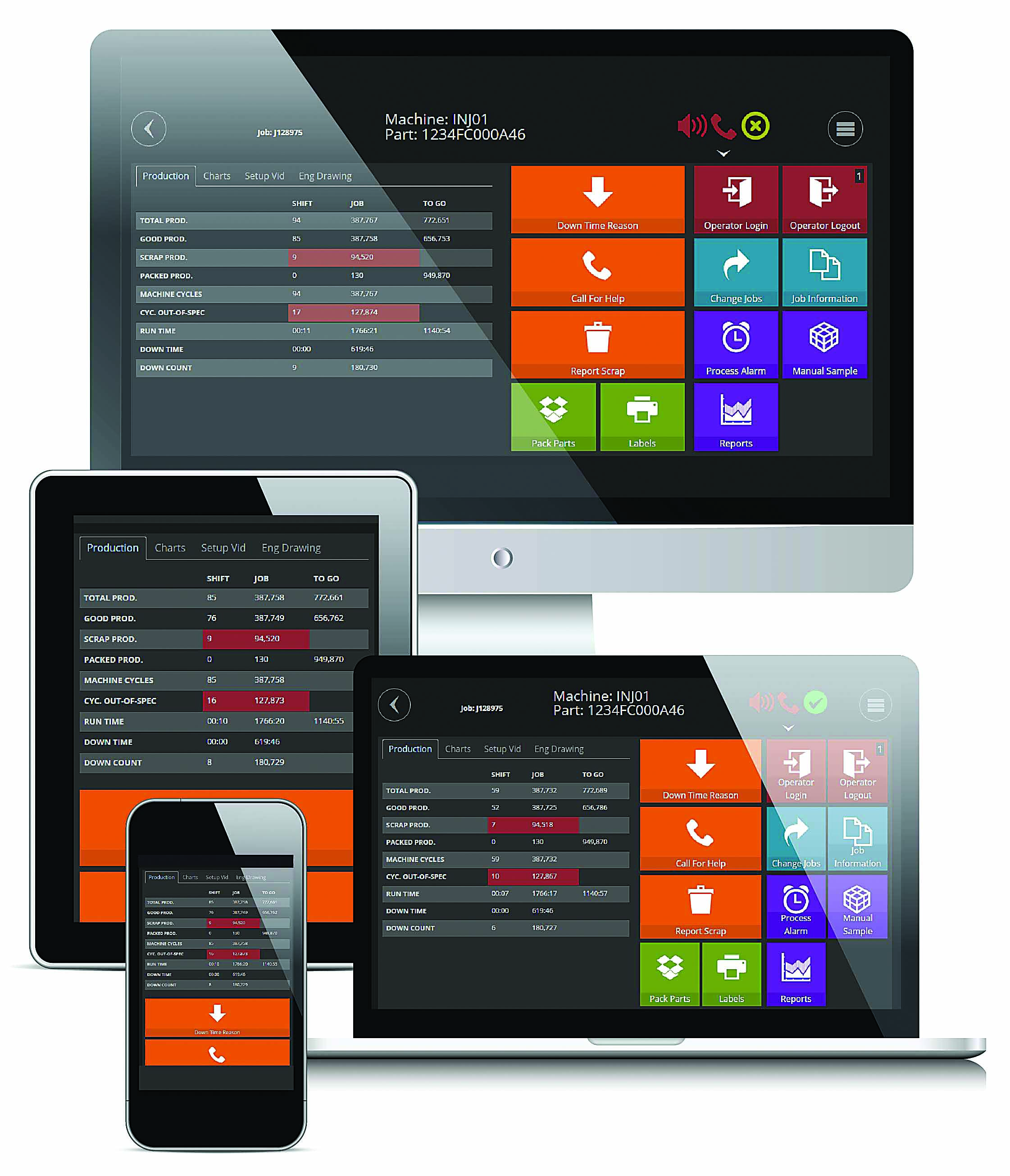

Virtually all MES software can be run on mobile devices, including Epicor’s Mattec MES software, which integrates with the company’s core ERP product. Image courtesy of Epicor Software.
