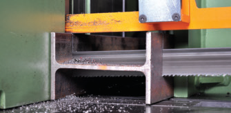

Bandsawing a structural workpiece, such as a steel H-beam, is challenging for the bandsaw blade. This is because as the blade enters the cut, it starts sawing the beam’s flanges before contacting the crossbar, or web. On average, each flange measures only about ½ ” wide while the web might be 20 ” wide.
Courtesy of Peddinghaus
Smart Saw technology from Peddinghaus automatically adjusts a bandsaw’s feed rate as the workpiece cutting area changes, such as when transitioning into a structural H-beam’s web from its flanges.
