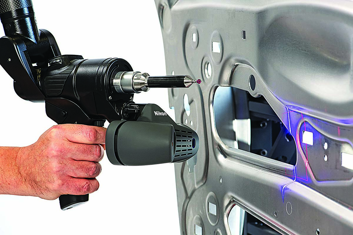

Gibbons said Nikon Metrology offers scanners that fall into two categories: ones that provide automated CNC scanning on a coordinate measuring machine and one that is mounted on an articulated arm for manual scanning. The former includes the L100, LC15Dx and XC65Dx laser scanners, and the latter is the ModelMaker H120, which is mounted on the MCAx S articulated arm.
“There are a lot of speed improvements that can come to a CMM program by adding scanning, because now we don’t have to stop at each one of those features and take a handful of points,” he said. “We can continuously move over it.”

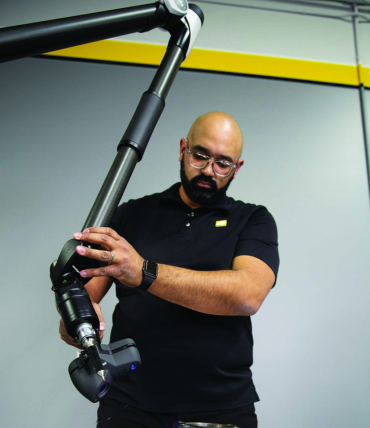

Hexagon offers multiple options to fit a customer’s application, including the RS5, RS-Squared Area Scanner and AS1 modular scanners, Winters said, adding that the AS1 is the most popular. The default scanning mode for the AS1 is SHINE, which stands for systematic high intelligence noise elimination. He said it dynamically evaluates the optimal exposure on each individual point to get the highest-quality data possible without any user intervention. It is a type of HDR, or high data rate+, technology that allows surface types to be scanned accurately without a reduction of the frame rate or laser line width.
“It ensures full scanner performance all the time,” he said. “We also have some external scanners that can be integrated for the seven-axis arm, such as the HP-L-20.8, and for the six-axis arm with the HP-L-8.9.”
The HP-L-8.9 laser scanner, for instance, is compatible with all six-axis Absolute Arm portable CMMs and can switch from laser scanning to tactile probing without any kind of calibration, the company reports.

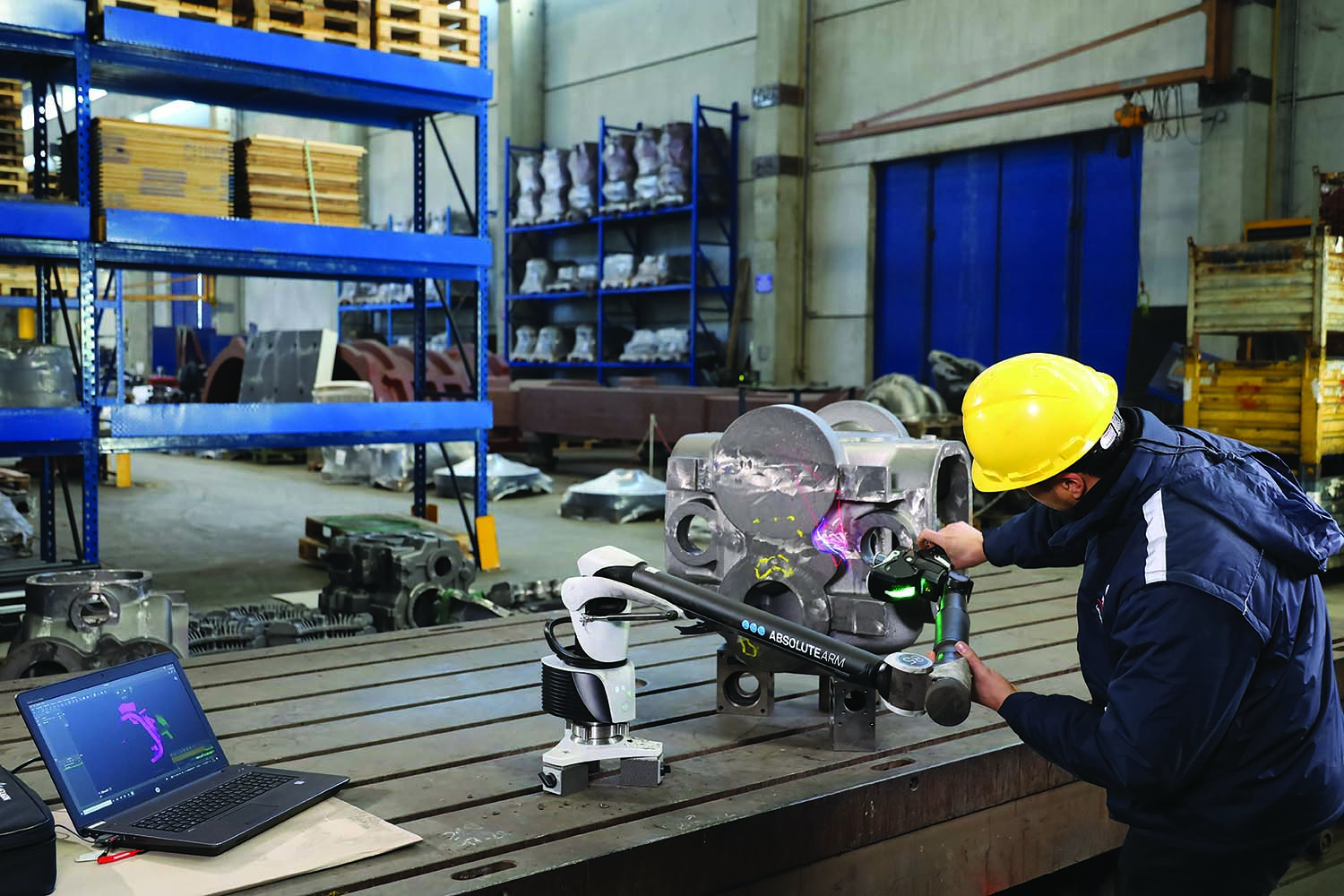

Winters noted that Absolute Arm portable CMMs are sealed to protect them from the dust, debris and fluids commonly found at machine shops, and they offer a wide operating temperature range of 5 to 45 degrees Celsius (41 to 113 degrees Fahrenheit). This is the only portable arm that offers that level of ingress protection, according to the company.
“We offer a completely wireless version that allows you to park the arm on a machine and leave it there for in-process inspection checks,” he said. “This version eliminates any cables or hazards on the floor, and with additional hot-swap batteries you can work indefinitely in this mode.”

“One play on tactile is that it doesn’t care about the surface itself,” Winters said, referencing parts with surfaces that are reflective, shiny or black. “With the latest capabilities from laser technology, one can deliver complete 3D scan data from many surfaces, including highly reflective and nearly transparent ones.”
A reflective or dark surface can be more challenging for a laser scanner, but Gibbons said the latest scanners perform effectively on those types of surfaces compared with some previous generations of equipment. Nikon Metrology’s interface software for scanners has reflection filtering and can account for “noise” generated during the process.
“Our ESP4 technology gives us the ability to adjust laser intensity of each point on the laser stripe,” he said. “We can account for changes in reflectivity, color or texture of the part in real time.”
In addition, Gibbons said scanning techniques can be implemented to reduce any reflection that might impact the image, such as changing the laser angle.
“Overall,” he said, “our scanners handle challenging surface conditions pretty well.”
