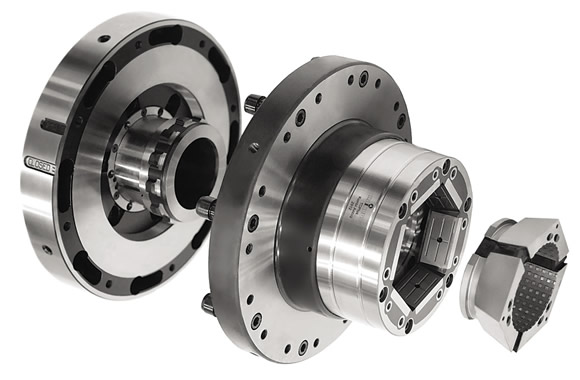

Swapping a Centrotex chuck takes under a minute, and is guaranteed to 5µm runout and repeatability, according to Hainbuch America.
Exploded view of Hainbuch’s TOPlus collet system together with a Centrotex masterplate.

Hainbuch America Corp., Germantown, Wis., addresses this weakest link with its Centrotex quick-change workholder. Guri Singh, Hainbuch’s CNC production manager, said: “Centrotex is a way to quickly change the entire chuck, rather than just the jaws themselves. It works off a pair of male and female tapers separated by precision ball bearings. Similar to the way a Sandvik Coromant Capto system works, everything is manufactured in such a way that the deformation of those three components is very precisely controlled, giving you extremely rigid clamping together with accuracy. It’s a mechanism difficult to manufacture but very simple and robust to use.”

Another important feature in a quick-change chuck is interoperability. Switching from one brand’s 3-jaw chuck to its collet chuck in a minute flat is swell, but switching from brand A’s 3-jaw chuck to brand B’s collet chuck to brand C’s expanding mandrel is better than chocolate cake on your birthday. “In a Centrotex environment, each machine is equipped with a permanent master plate,” Singh said. “Each workholding device you wish to quick-change among those machines is then adapted to that master via a matching plate.”
