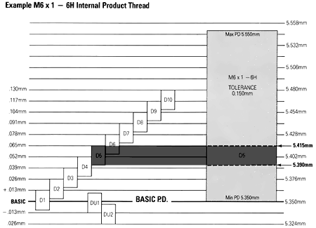

Again, we are keeping the identical conditions in place, but now the thread size is M651.0 6H. Many people are uncomfortable with metric, but we’ll all have to get used to the idea. So let’s take a moment to look at some of the terminology and designations of metric taps.
Aside from the fact that dimensions are listed in millimeters instead of inches, the metric system describes the pitch of the screw thread, rather than the threads per inch (tpi) described in the Unified System. Therefore, a 1mm pitch is just that: it indicates a distance of 1mm from the crest of one thread to the crest of an adjacent thread. For every revolution the tap makes, it has to advance 1mm.
The 6H indicates an internal thread machined to a medium tolerance—it is comparable to 2B fractional threads. To produce the proper thread size in a Class 6H fit, we must control the tap size with D-limits, the metric equivalent of H-limits. A D-5 limit should be chosen to tap an M651.0 6H thread.
Figure 2: D-limit designations for metric taps, in this case an M6x1-6H tap.
How do D-limits affect tap size? The pitch diameter of the tap increases 0.013mm (0.0005") between successive tap-limit numbers, the same rate of increase found with H-limits. The tolerance of each D-limit number for smaller taps is also 0.013mm, or 0.0005". Therefore, the high side of a D-5 limit on a tap pitch diameter is 0.0025" over basic pitch diameter (Figure 2).
As with H-limits, D-limits increase in tolerance as thread size increases. The D-5 limit for the M6 tap has a pitch-diameter range from a high of 5.415mm to a low of 5.390mm. This is a tolerance of 0.025mm (0.00098"). Rounded off to 0.001", this is the same amount of tolerance covered by an H-4 limit for a tap over 1" in diameter.
Let’s apply this to the part we are tapping and then heat treating. Unaware of the D-limit tolerance, we use a standard tap with a D-5 limit for our M651.0 6H thread, as recommended by MCTI or the tap manufacturers’ catalogs. After we notice the extent of the thread distortion caused by heat treating, we decide to use a D-7 limit on the tap. If the D-5 tap was on the high side of the limit and the D-7 tap is on the low side of the limit, our actual change in tap size could be less than 0.0001". This would leave us with the same undersize threaded hole, and we would have no idea why it happened.
