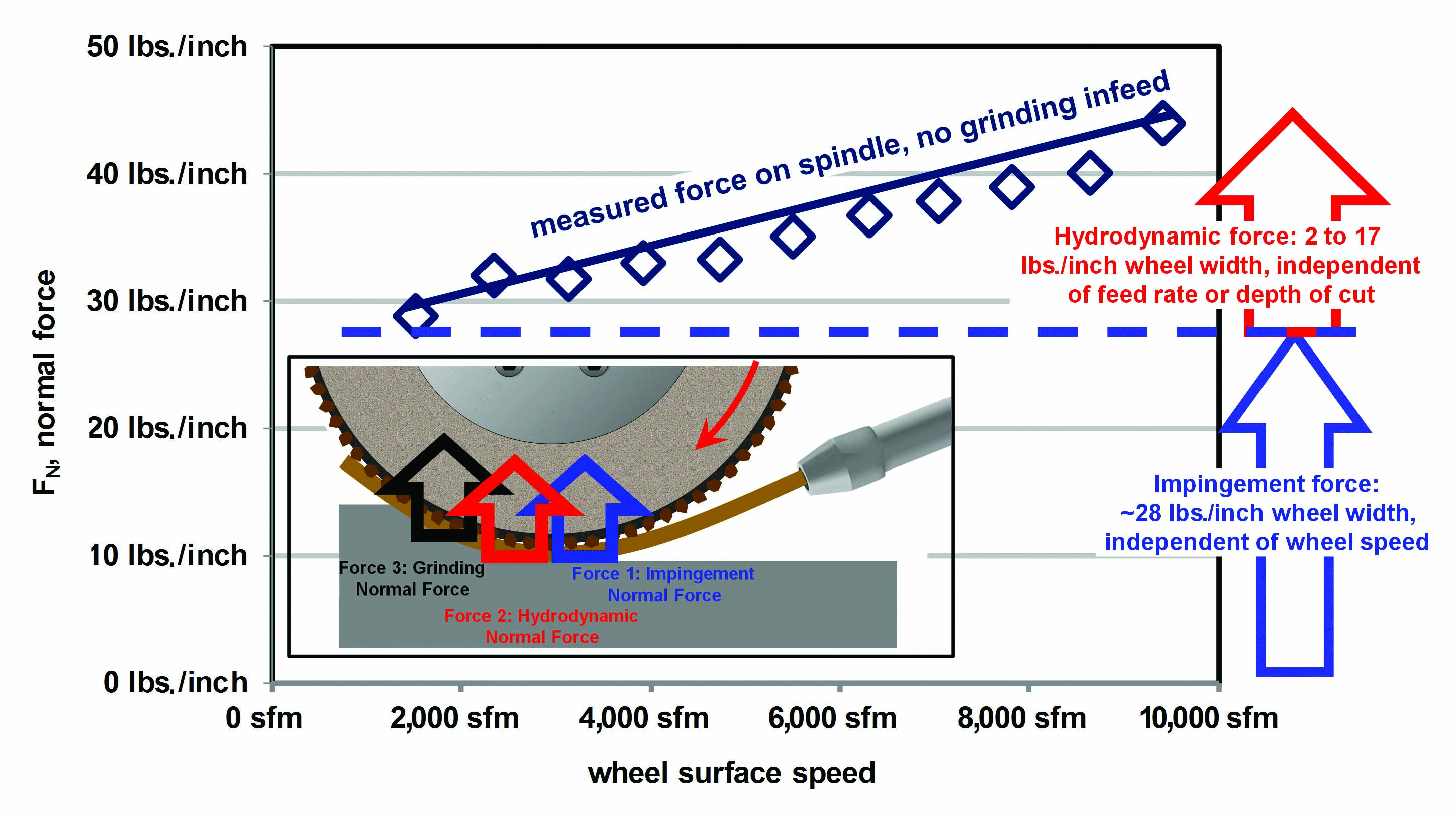

The late grinding guru Stephen Malkin divided coolant forces into the impingement force
and the hydrodynamic force. These forces can become huge and cause serious part deflection.
Image from “Measurement of Hydrodynamic Forces in Grinding” by M. Ganesan, C. Guo and S. Malkin.

Duck 3: Avoid hydroplaning. Here things get tricky. During grinding, you want effective cooling. But effective cooling creates hydroplaning forces, which can be as high as 50 lbs./in. of wheel width. During sparkout, that hydroplaning force is much bigger than the grinding force, causing both roundness and size issues. The solution is to gradually throttle back coolant pressure during finishing and sparkout. For tight tolerances, reducing hydroplaning forces helps enormously.
