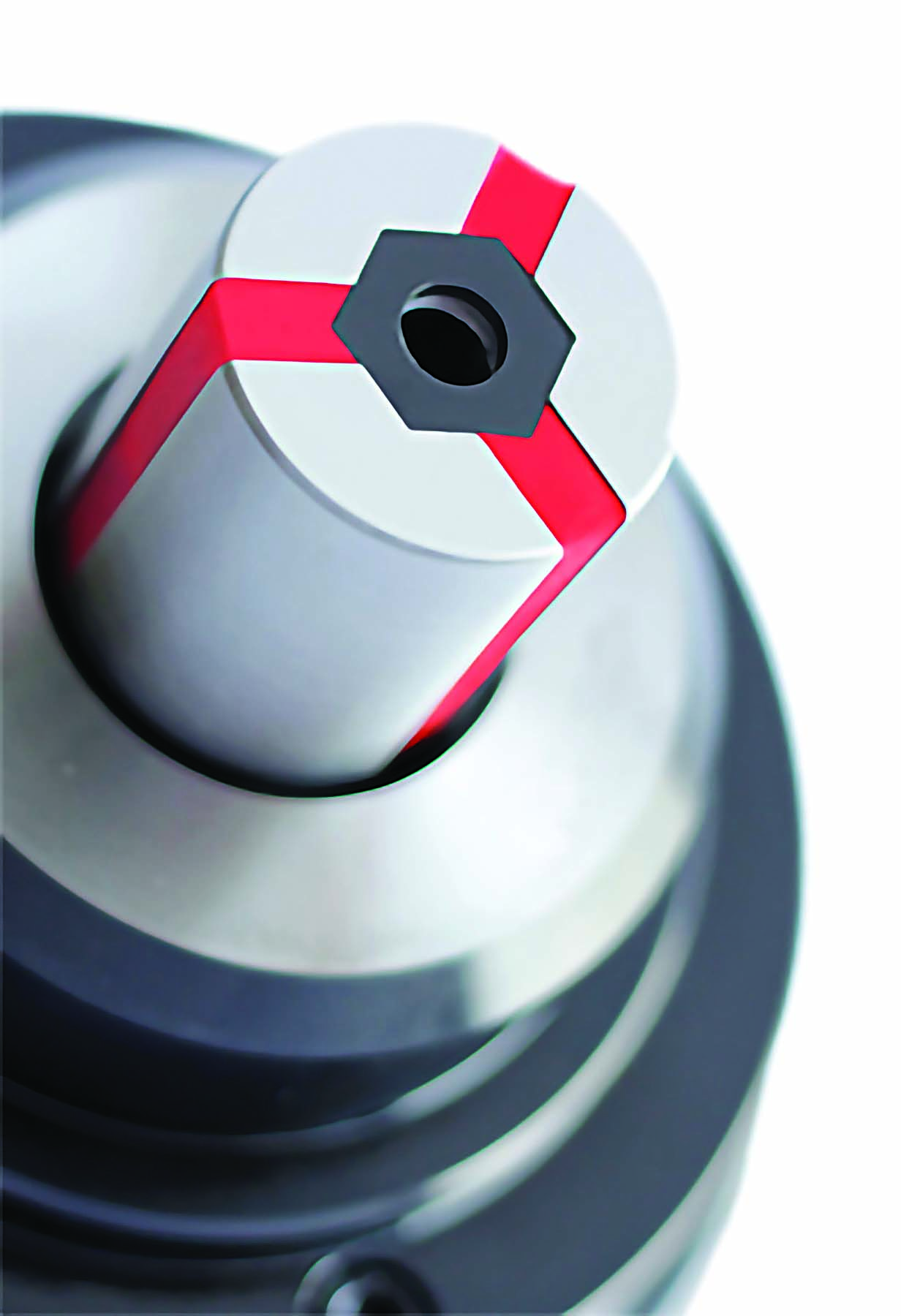

The need to transfer a part from one machine to another or, in the case of multi-spindle machines, from one workstation to another can frequently result in misalignment. Further, successfully transferring parts requires expertise and experience on the part of the machine operator. Look for workholding systems designed for fast and foolproof change-over, whether changing from different parts in the same spindle or moving the workpiece for a secondary operation. Changes can be accomplished in a matter of seconds with maximum repeatability and require no special operator training. An example of this is Hainbuch’s new MAXXOS hexagonal mandrel that maximizes transmission forces, results in less tool wear, and delivers up to 57% higher rigidity with a possible achievable runout of ±2 µm.
