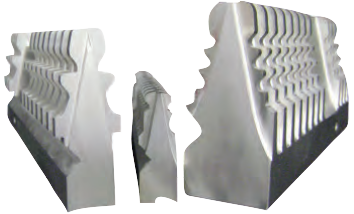

General Broach employs a Blohm Planomat CNC surface and profile grinder to produce broach tool segments with complex “fir-tree” profiles.
Typical of the aerospace part features cut with GBC broaches are slots in titanium or nickel-base alloy turbine engine compressor discs. The slots hold turbine blades around the disc periphery and are generally broached to an irregular V-shape that resembles a fir tree. A single turbine disc may require 90 to 100 slots.
View this brief video to see an animated demonstration of slot broaching.
Depending on the disc being machined, a full set of broaches may consist of eight to 10 segments of tools that together measure 100 ” to 300 ” in length. Individual segments range from 4 ” to 39 ” long, 0.6250 ” to 2.5 ” wide and 1.0 ” to 2.5 ” high. In the first segments in a set, the teeth usually are simple shapes. In succeeding segments, the teeth become larger, change form and eventually reach the final fir-tree configuration. The tools usually are ground from PMT-15 P/M alloy, Stover said, adding that they are rarely coated because most are titanium-based coatings, which chemically react with titanium workpieces.
