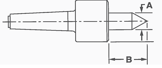

Figure 1. Live center modifications typically include point length (B) and diameter (A). All images courtesy Riten Industries.
However, the demand for unique production operations can frequently be satisfied by a simple custom-engineered workholding solution rather than an expensive dedicated machine. In my 26 years at Riten Industries, I’ve seen explosive growth in customer specials, which make up 40 percent of our sales.

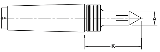

It started years ago as a quote to provide extra tool clearance by changing the point length and diameter of a standard live center (Figure 1). Grinder operators also requested dead centers in nonstandard lengths and point diameters (Figure 2). This allowed grinding various part lengths, which saved setup time by eliminating the need to reposition the machine tailstock and recenter the machine. These types of requests led to the creation of a new production cell for specials. The relatively simple dimensional modifications to existing products were, for many years, the sole workload for the specials department.
Figure 2. Nonstandard lengths (K) are a common request on dead centers for grinders.

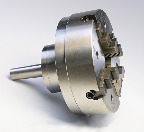

- Center holes on roll journals often take a beating when replacement bearings are installed, rendering the center hole unusable. Also, depending on the repair process, refurbished rolls can end up with journals that are misaligned with the center holes, making future repairs problematic. Machining a new center hole can be difficult and time-consuming. Several customers sought a solution. Our answer was a live chuck mandrel that combined the rotational accuracy of a live center with the flexibility of a 4-jaw chuck (Figure 4). The mandrel chucks on the bearing journals of the roll, bypassing the damaged center hole. Simple indication of the roll while adjusting the 4-jaw chuck brings the part back on centerline. Alternately, where the center hole is in good condition but no longer on center, the mandrel can chuck a dead center and dial in the part by adjusting the chuck jaws.

Figure 4. This live chuck mandrel can center rolls with damaged center holes.
