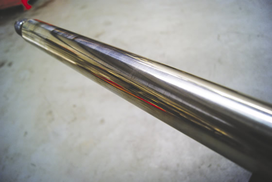

A part coated with the Corex tungsten-chromium-carbide compound from Apex Hydraulics.
In addition, HCP porosity is 5 to 10 percent, and HCP experiences microcracking in all circumstances, with the amount varying based on the manufacturer, according to Oldroyd. As an alternative, Apex Hydraulics introduced the Corex tungsten-chromium-carbide compound after 2 years of R&D. Oldroyd pointed out that the dense, cohesive rod coating has a porosity of less than 1 percent, a hardness up to 1,400 HV, a bond strength greater than 10,000 psi and doesn’t experience microcracking. In comparison, HCP has a hardness of 750 to 850 HV and a bond strength of less than 5,000 psi.

“Hard chrome plating offers good all-round performance,” he said. “But where improvements are needed, Corex is the superior solution.”
Those applications include mechanical components in the hydraulic industry, because they suffer extreme abrasive wear and corrosion under high environmental pressures and long, continuous usage. The coating thickness is from 0.004 ” to 0.012 ” (0.102mm to 0.305mm), and Corex increases cylinder life, durability, efficiency and performance, according to the company. Therefore, the coating enables machinery to cope with low-lubricity fluids.
Oldroyd added that Corex-coated cylinders can run on pure water, and the coating’s hardness resists high levels of contamination. “Contamination will always reduce the life of any cylinder, but the cause of failure can be moved from an expensive rod to [lower-cost] soft parts,” he said, noting any metal can be coated. “We also upgrade other components with the coating, creating big gains in applications where contact with contaminated fluid is unavoidable.”
